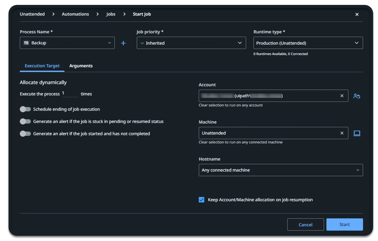

Navigate to Automations > Jobs from the folder that the process resides in.
Click Start. The Start Job window is displayed.
From the Process Name drop-down, select a process that has been previously deployed to the current folder.
Configure the required fields, as follows:
Click Start. The Start Job window closes and, if there are available runtimes on the currently active folder, the job starts on a Robot according to the settings you made. The State of the job is displayed in real-time on the Jobs page.

Allocate Dynamically
Dynamic allocation with no explicit account and machine selection allows you to execute a foreground process multiple times under the account and machine that become available first. Background processes get executed on any account, regardless if it's busy or not, as long as you have sufficient runtimes.
Using this option you can execute a process up to 10000 times in one job.
Account
You can choose one of these approaches:
- Specifying an account means the process is executed under that specific user or robot account.
- Specifying both the account and the machine means the job launches on that very account-machine pair. Only valid account-machine pairs are available for selection.
- Specifying no account results in Orchestrator allocating the account dynamically.
Machine
- Specifying a machine object means the process is executed on one of the host machines attached to the selected machine template. Select a specific host machine from the pool of connected host machines on the Connected Machines field.
- Specifying no machine results in Orchestrator allocating the host machine dynamically.
Make sure that runtimes matching the job type are allocated to the associated machine template. Only connected host machines associated with the active folder are displayed.
Keep Account/Machine allocation on job resumption
This field allows you to configure whether the different fragments of a long-running job are executed on the same account-machine pair.
By default, a suspended job is resumed on any available robot on any available machine.
Based on your license or resource requirements, you have the option to resume a job on the same machine and in the same account context that started the job.
Say you need an SAP license to execute a job. Instead of installing an SAP license on every available machine (increased costs), you can install it on a single machine and use that machine to start and resume the job. The same strategy may apply to user licenses. You can allocate only one user license and use it to execute the job.

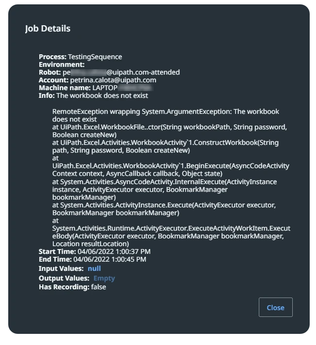

Viewing Job Details
To view details about a specific job, follow these steps:
Click the corresponding View Details button. The Job Details window is displayed. Here you can find various information such as the name of the underlying process, the executing robot and machine, the reason behind jobs failing, etc.
Note:The Info field does not display licensing considerations for jobs failing. Use the monitoring functionality for details on licensing.
