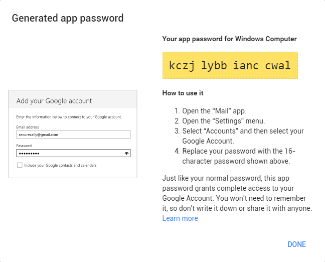

Considering you want to receive email alerts via Gmail, the following procedure walks you through the Gmail SMTP server configuration:
Example of Setting Up Email Alerts With Google SMTP Server
Sign in using the email address which is to send mail messages from Orchestrator.
From the Select App drop-down list, select Mail.
From the Select Device drop-down list, select Windows Computer.
Select Generate. The Generated App Password window containing an app password is displayed.
Copy the generated app password to clipboard.
