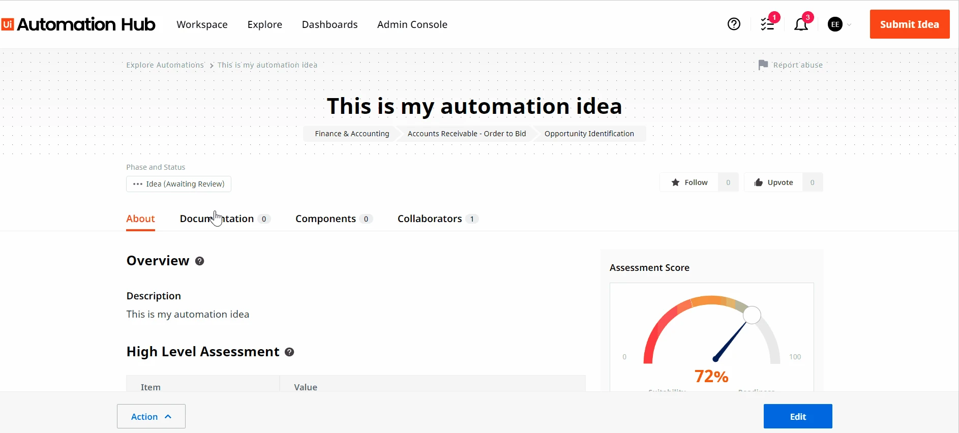

  • The page displayed after an Employee-driven idea was submitted
    This page contains the idea score and the option to document the submitted idea using Task Capture. The option is available for the idea submitter. Access the page to find out more.

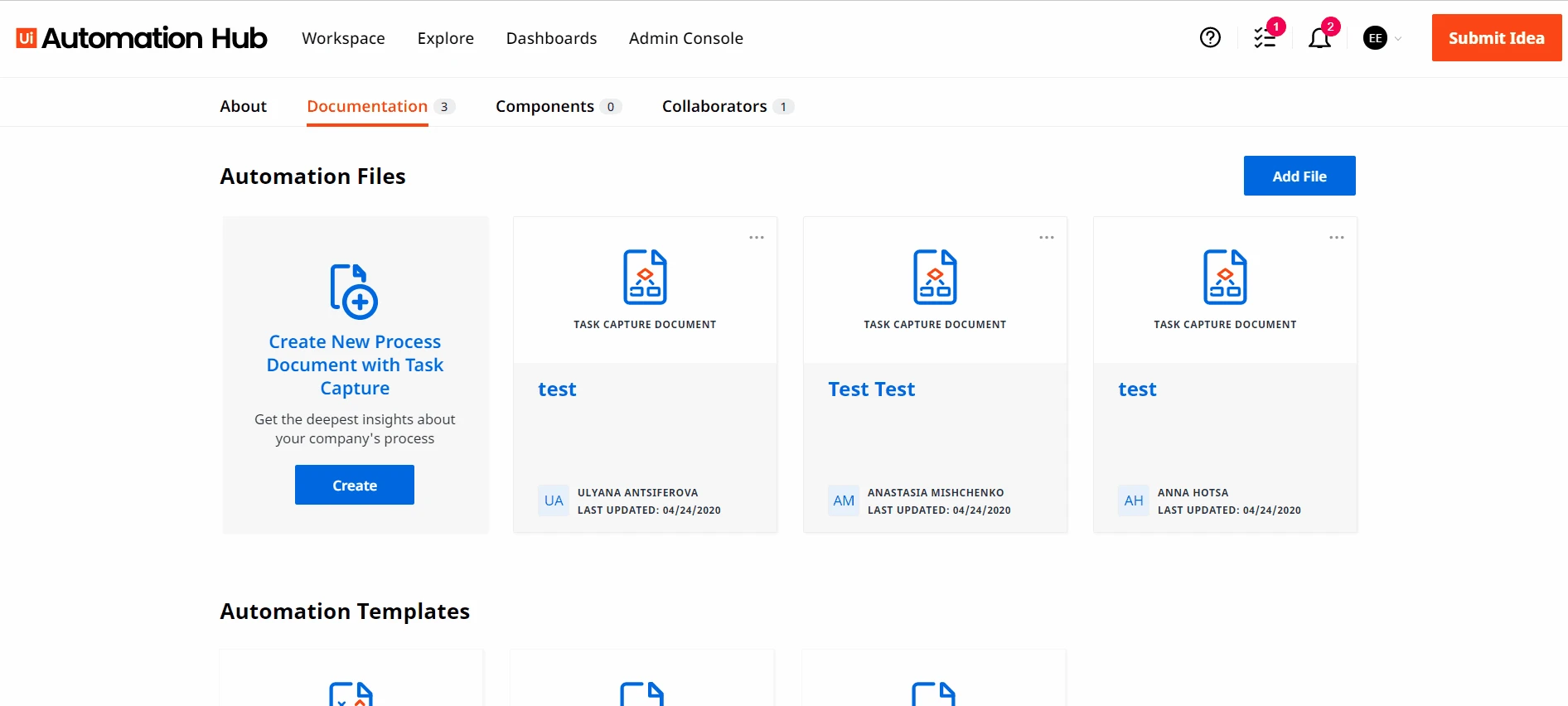

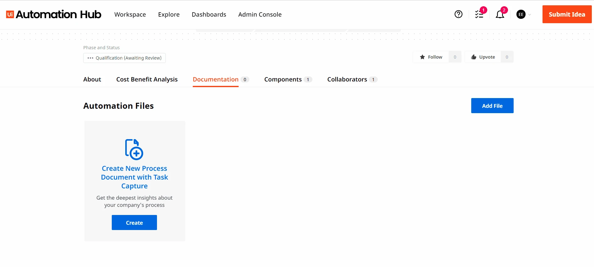

  • The Documentation module under both the Idea and Automation Profile pages
    The pages contain the documentation added to support the idea or automation submissions. The option to add documentation and use Task Capture for capturing processes is available only for the idea/automation submitter and users assigned with editing rights for the Documentation section.
Access the to find out more.

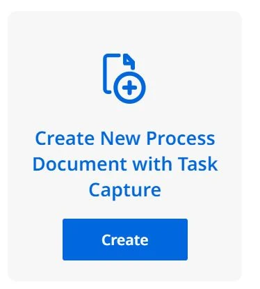

Create New Process Document With Task Capture​
The Create New Process Document with Task Capture card is displayed in both of the above-mentioned locations.
Once you click Create you have the below options:

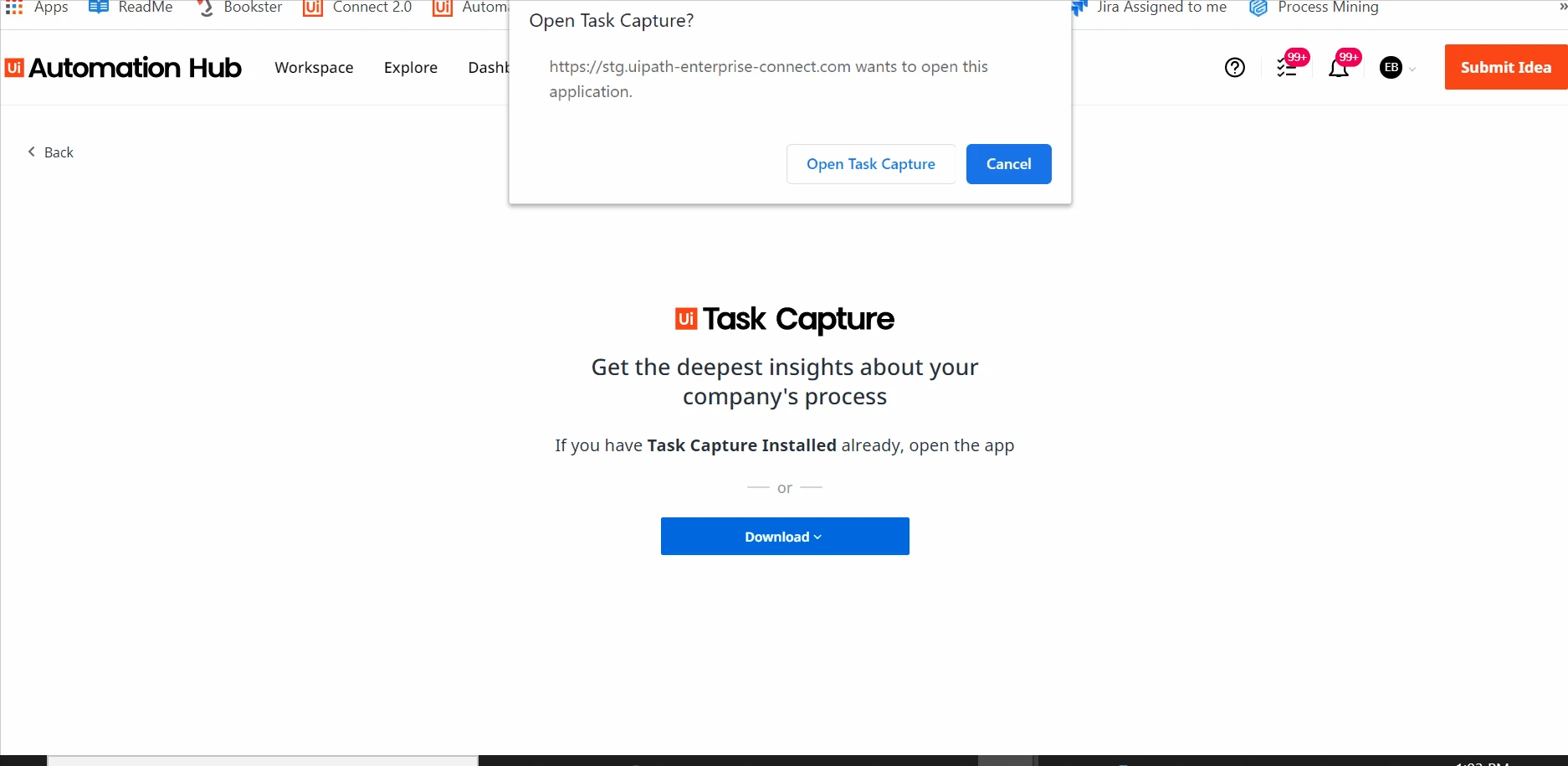

Open Task Capture​
Click the Open Task Capture button from the pop-up window. The tool is displayed allowing you to start capturing the process needed to document your assessment.
In case the language set up in Automation Hub is different from the one in Task Capture, a message is displayed in Task Capture allowing you to switch the Task Capture language to the one set up in Automation Hub.
Note:
The Task Capture tool will not open if you do not have it installed on your PC or if the version is lower than 20.4. To resolve this issue click the Download drop-down list and follow the steps from the Download Task Capture page.

To open the attached documentation follow the steps below:
  1. Click the file card.
  2. Click Download.
  3. Select where you want to save the ZIP file and click Save.
  4. Once the ZIP is saved open it.
  5. The recorded process details are available in .ssp, .docx, .xaml and .jpg files.
