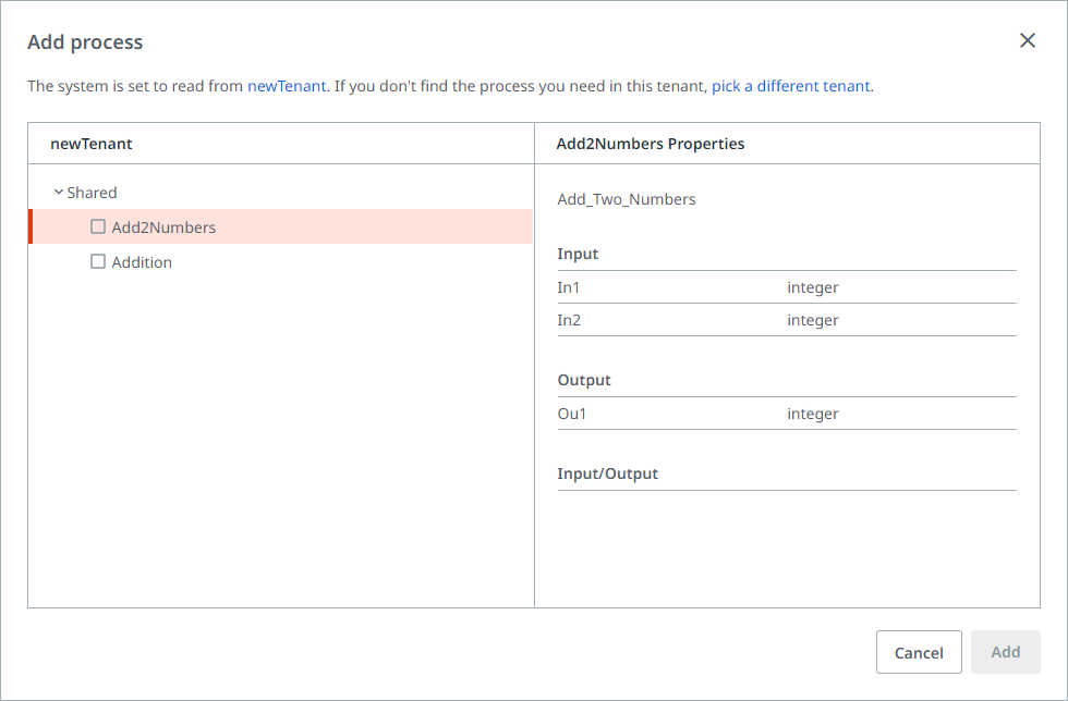

  1. From an existing app in App Studio, expand the dropdown menu at the right of the Add control button.
  2. Select Process.
  3. A list of tenants for the current account is displayed. Select the tenant that hosts the process you need to reference, then click Next.
  4. The Add process wizard opens, displaying the list of processes in the selected tenant, grouped by folders.
  5. Select one or more processes. The right-hand panel displays the description, and the input and output arguments of the highlighted process.
  6. Check the box next to the process you want to use in your app and click Add.
