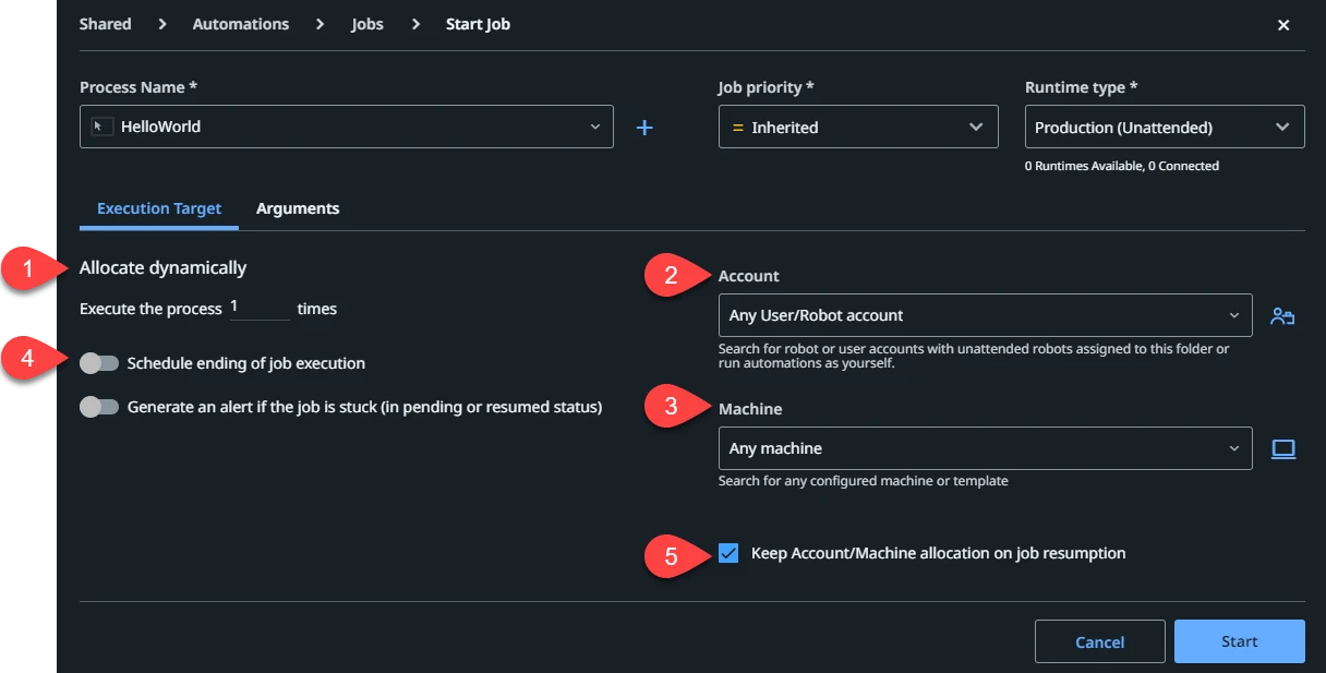

Account-Machine Mappings​
When starting a job or defining a trigger, you can define specific account-machine pairs on which execution takes place. Account-machine mappings enable you to tie unattended usage under particular accounts to specific machine templates. The gives granular control over the execution targets of your automation. Account-machine mappings can be tenant-based (not tied to a specific folder), or folder-based (tied to a specific folder).
Execution Target​
According to the mechanism used for launching jobs in Orchestrator, you can choose and configure a job allocation strategy and an execution target, implicitly. This article describes the allocation strategies and execution targets available when launching jobs from the Jobs page.
Note:
If your job execution depends on a specific resource that is not yet available, the job remains in the pending state until the conditions for the jobs execution are met.
For example, user U1 connects to the hostname H1 using credentials C1. However, the wrong credentials C2 are inputted to connect to the hostname. Therefore, the job enters the pending state. If you later update the credentials to the correct ones (that is, C1), the job resumes its execution.
Note:
If the Robot becomes unresponsive (the robot machine is down, or the Robot Service crashes) during job execution, after reconnecting, it restarts the execution of the jobs that were running during the crash.
1. Allocate Dynamically​
Dynamic allocation with no explicit account and machine selection allows you to execute a foreground process multiple times under the account and machine that become available first. Background processes get executed on any account, regardless if it's busy or not, as long as you have sufficient runtimes.
Using the Allocate Dynamically option you can execute a process up to 10000 times in one job.
2. Account​
The process is executed under a specific user or robot account. Specifying only the account results in Orchestrator allocating the machine dynamically. Specifying both the account and the machine means the job launches on that very account-machine pair.
3. Machine​
The process is executed on one of the host machines attached to the selected machine template. Specifying the template displays an additional Hostname option, allowing you to select a specific host machine from the pool of connected host machines. Specifying only the machine results in Orchestrator allocating the account dynamically. Specifying both the account and the machine means the job launches on that very account-machine pair.
Make sure that runtimes matching the job type are allocated to the associated machine template. Only connected host machines associated with the active folder are displayed.
4. Schedule ending of job execution​
The process execution may sometimes be faulty, causing the job to remain in the pending state. The toggle allows you to automate a strategy for stopping the job, by specifying the amount of time that can pass until the job is stopped or killed. To cover the case of a job that cannot be stopped, you have the option to kill the job.
5. Keep account-machine allocation on job resumption​
The process resumes their execution on any available robot on any available machine by default. To keep the same account-machine configuration ensures an optimized use of resources and license requirements.
