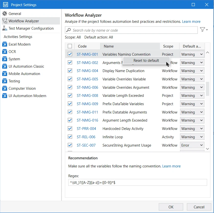

项目或文件的分析基于“项目设置”窗口中的一组规则:
  • 在“项目”面板中,单击 文档图像 图标,然后选择“工作流分析器”。
  • 在功能区中,单击“分析文件”按钮,然后从下拉列表中选择“工作流分析器设置”。

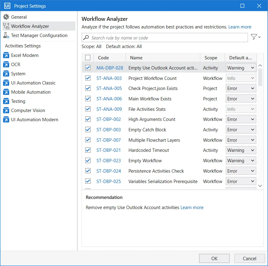

默认情况下,规则按窗口中的代码排列,并先显示已启用的规则。
使用窗口顶部的搜索框,按名称或代码搜索规则。要按作用域和默认操作筛选规则,请单击搜索框右侧的 文档图像 按钮。
配置规则
您可以使用规则左侧的复选框启用/禁用规则,也可以使用右侧的下拉列表更改默认操作。
Some rules require no additional configuration, while others contain parameters that you can configure, such as thresholds not to be exceeded, or lists of specific items that are allowed or prohibited. Please note that when you configure rules that contain text fields (for example SecureString Misusage or Package Restrictions), text shouldn't be entered between quotes.
重置为默认值
对规则的默认值(正则表达式或阈值)作出任何更改后,可以通过右键单击规则,然后选择“重置为默认值”来将值恢复为默认值。

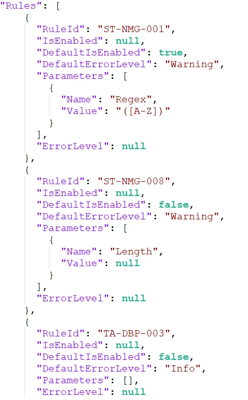

  • From the RuleConfig.json file, path %LocalAppData%\UiPath\Rules. Find a specific rule, modify its parameter, change the IsEnabled parameter to false to disable the rule. Optionally, if the path is not accessible, you can place the RuleConfig.json file in a custom location and include the path to the file in the command. For more information, see Analyze Files and Projects.
系统会按规则的唯一 ID 对其进行整理,并且会在“工作流分析器设置”中显示这些规则。
For example, in the image below only the Variables Naming Convention rule was enabled and received the ([A-Z]) Regex expression. This means that variable names must be uppercase. All the other rules were disabled in this example.
以下参数适用于每个规则:
