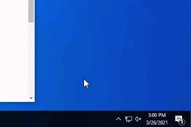

Stopping all Chrome instances
In some cases, Chrome background processes prevent it from closing completely, which interferes with automations even if the browser instance is not visible.
We recommend closing Chrome by right-clicking the Chrome icon in the System Tray, and selecting Exit. This ensures that no other user profiles remain in use in the background.
