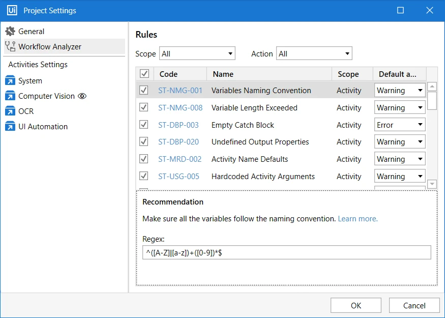

In the Project Settings window, select the Workflow Analyzer tab. Find the rule and select the rule, as in the image below:
In the Regex section, add or remove characters from the search pattern. For example, if we remove the [A-Z] part of the expression, the search pattern becomes ^([a-z])+([0-9])*$. Now the rule checks if variables start with a lower case letter and are followed by a number.
If we add [a-z]|[A-Z]), then the rule becomes ^([A-Z]|[a-z]+[a-z]|[A-Z])+([0-9])*$, and recognizes HelloWonderfulWorld as a valid variable name.

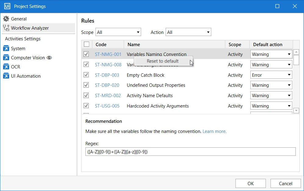

Reset to Default Values
The default value for ST-NMG-001 Regex is ^([A-Z]|[a-z])+([0-9])*$.
Some Workflow Analyzer rules have default values. To reset these values to default right-click a rule in the Project Settings window, and then click Reset to default.
