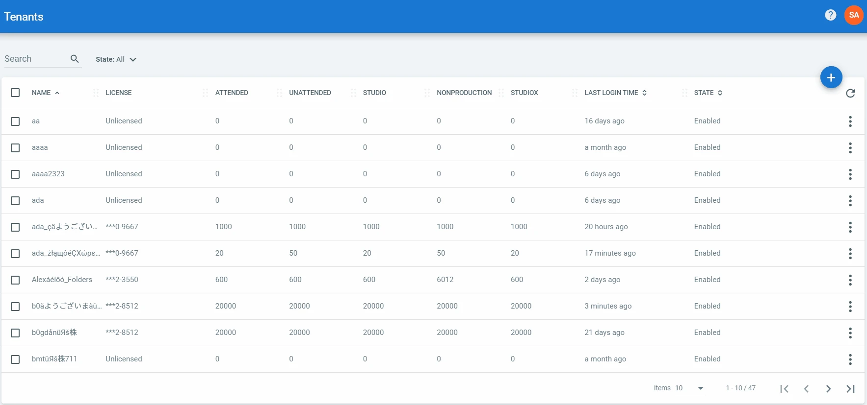

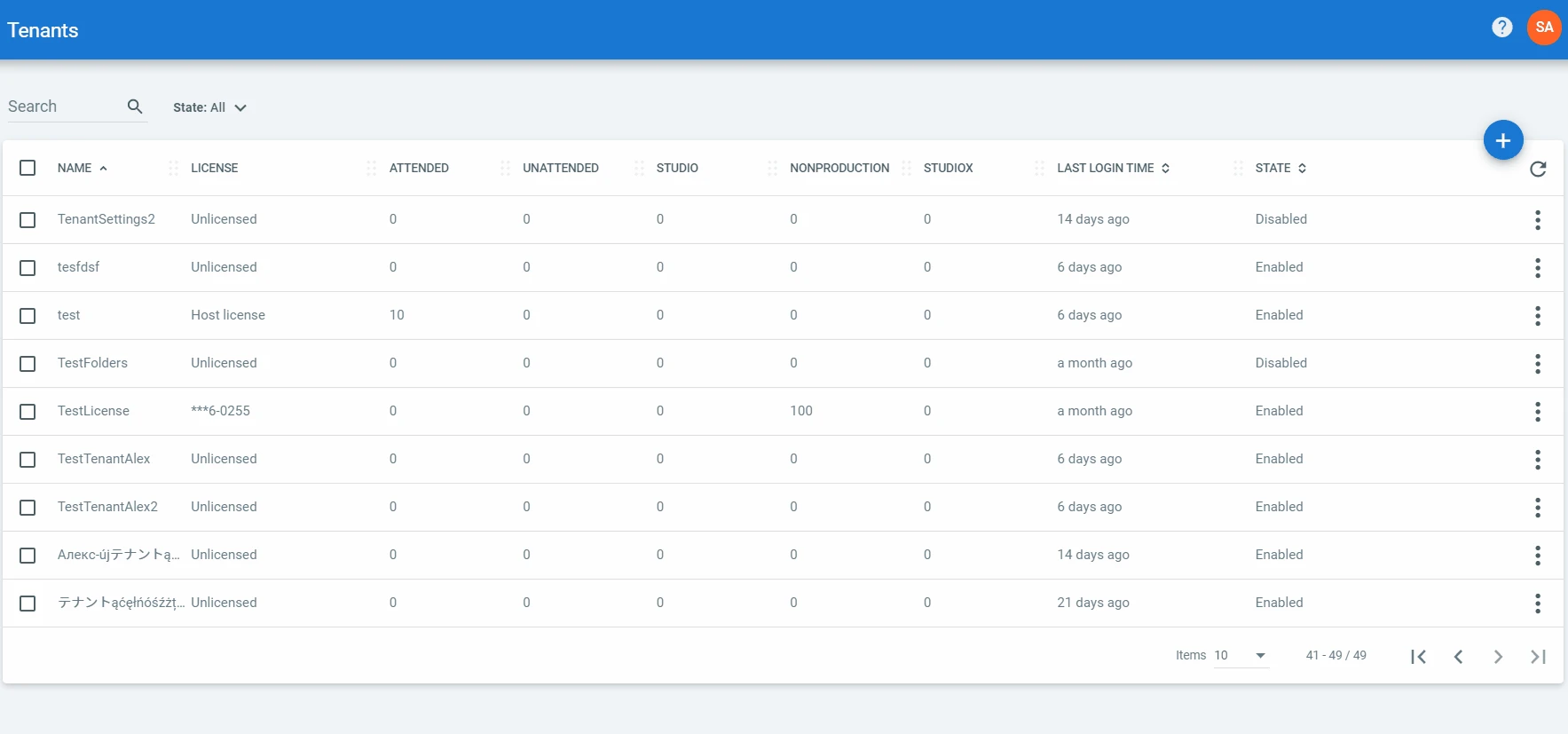

From the Tenants Page

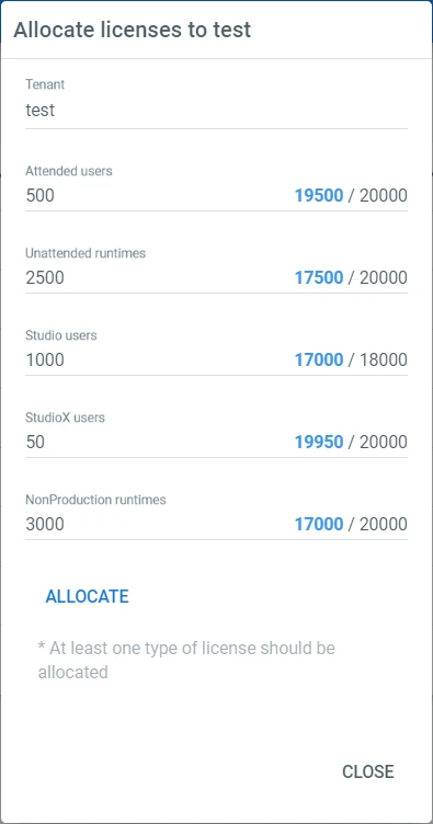

In the Tenants page, click the More Actions button for a tenant and select Allocate Licenses. The Allocate Licenses page is displayed.
Note:If the tenant is licensed you must first remove the existing license before starting to allocate new ones.
At the end of each row you can see the number of available licenses (in blue) and their total number at host level. Allocate licenses as you wish, keeping in mind that you cannot exceed the total number available.
Click Allocate. Observe that the Tenants page has been updated according to your changes. Take into account that the Allocate button is only enabled if you make some changes.

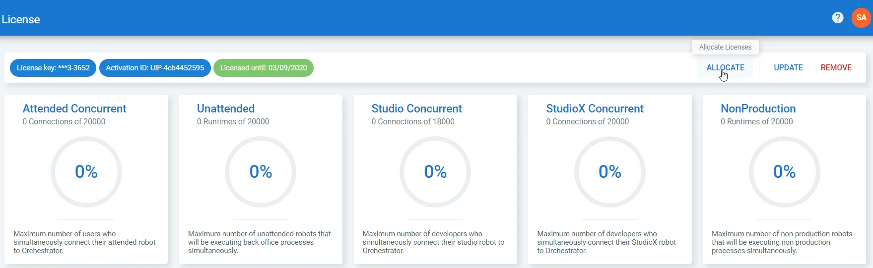

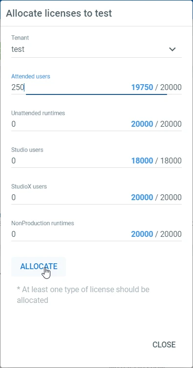

From the License Page
Click Allocate. The Allocate Licenses window is displayed.
Choose the desired tenant from the Tenants drop-down list or simply fill in its name.
Allocate the Robot licenses as needed, as long as they are within the limit of each category, and click Allocate. Observe that the Allocate Licenses window is updated.
This page is only available at host level.
As this page represents a centralized location of all tenants, you can remove licenses for multiple of them.
In the Tenants page, click the More Actions button next to the desired tenant and select Allocate Licenses. The Allocate Licenses window is displayed.
For deleting the license from the tenant, click Remove. Note that the Remove button is only displayed for already licensed tenants. Click Yes to confirm when prompted. The Allocate Licenses window is updated.
Click Close. Observe that the Tenants page is updated as well, and on the License column, your tenant is displayed as Unlicensed.

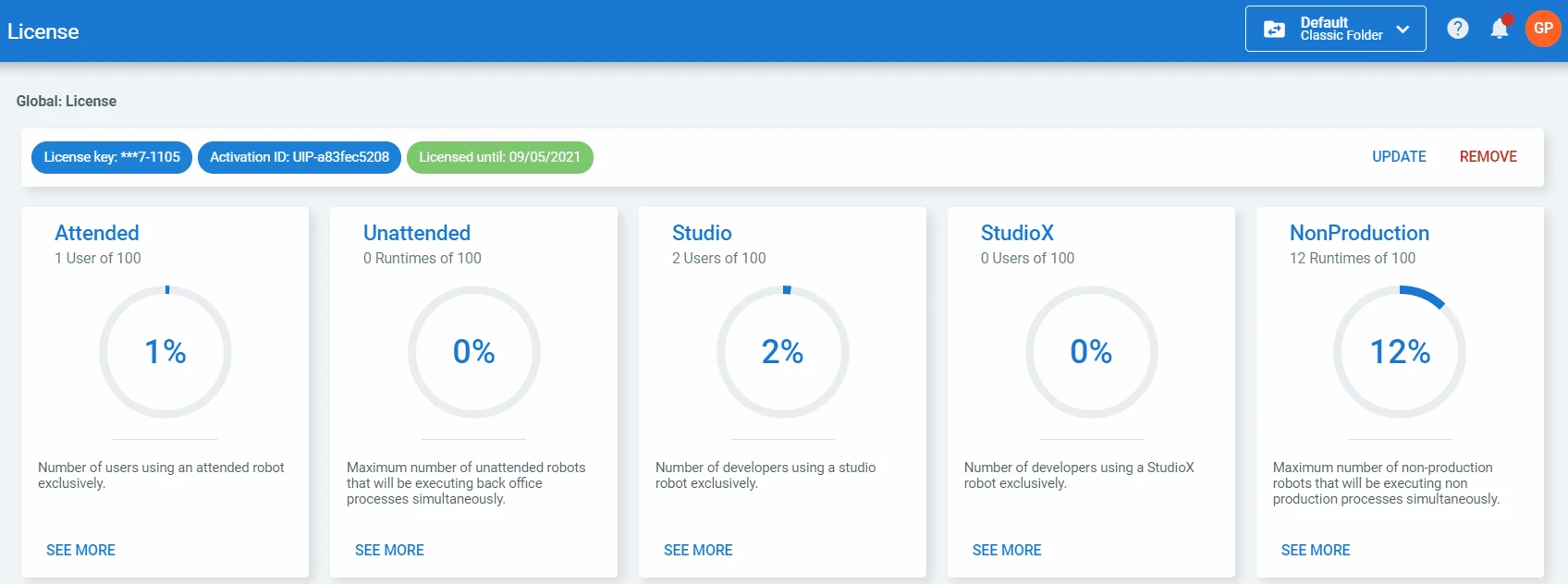

Displaying License Details
To view more information about how Robot licenses are consumed per type, click the corresponding See More button in the License page at tenant level. A page with the corresponding name is displayed:
- Attended
- Unattended
- Studio
- StudioX
- NonProduction

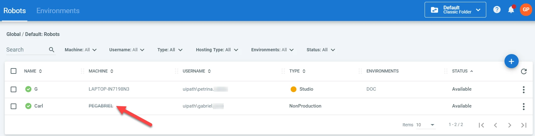

Enabling/Disabling a Machine
Only available for Unattended and NonProduction-purposed machines. Disable a machine to prevent instant license consumption. Enable a disabled machine in order to be able to use Studio and/or the Robot. More details here.
In the License page, click See More for the type of license that interests you (Unattended or NonProduction). The corresponding page is displayed.
Turn off the toggle in the Active column. A dialog is displayed asking for confirmation on disabling the machine.
Click Yes. The machine is disabled.
Turn on the toggle to enable the machine.
A disabled machine is displayed as stricken-through on the Robots page:
Keep in mind that you cannot disable a machine as long as Robots on that machine are still running.
