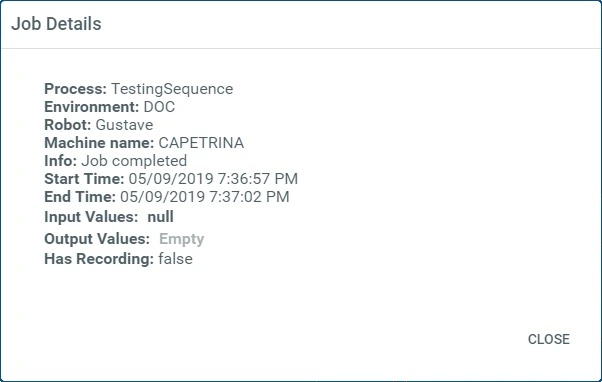

To view more information about all job executions, click the corresponding Details button. The Job Details window is displayed and enables you to view why a job faulted. Additionally, for unattended faulted jobs, if your process had the Enable Recording option switched on, you can also download the corresponding execution media and check the last moments of the execution before failure.
