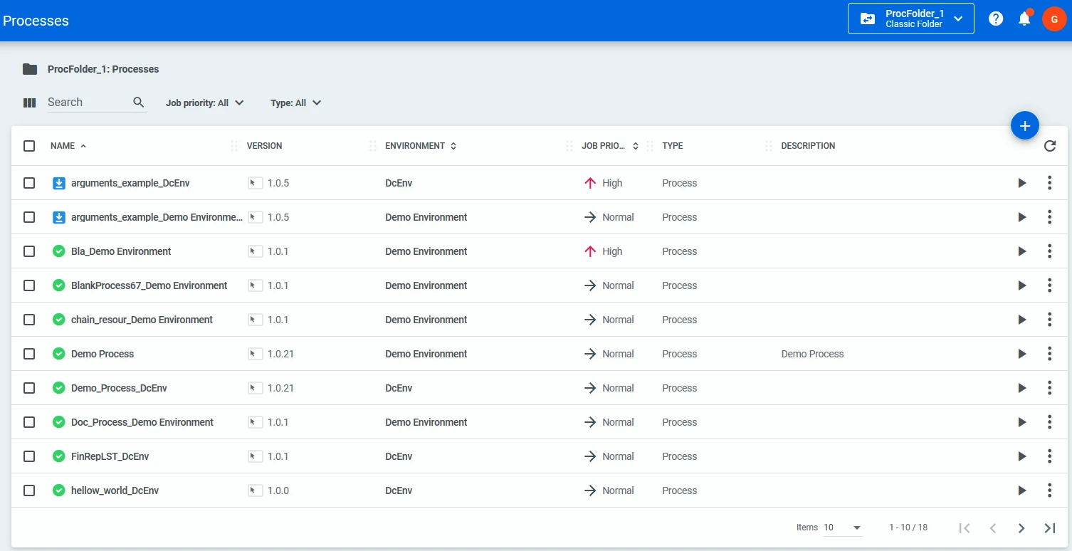

A process represents the package version linked to a particular folder. When you deploy a new process, it becomes available for all the users that have access to that folder.
The Processes page enables you to deploy an uploaded package as a new process, manage previously created processes, keep all your processes up to date with the most recent package versions, and directly start a job using the desired process. This helps you distribute packages across all users and robots in your organization and execute processes faster, whether from the Processes or Jobs page.
In addition to executing processes from the Processes and Jobs pages you can also configure any process to automatically start when the Robot agent is launched. As an administrator, this enables you to be sure that necessary processes are launched without delay or failure from the machine user, for example to ensure adherence to company IT policies.

Note that creating a process requires your user to have View permission on Packages, and View and Create permissions on Processes. You also need Create on Jobs to instantly start a job from the processes page. For deploying processes in classic folders, View on Environments is also required.
If the Main.xaml of your process has In, Out, or In/Out arguments, they are displayed on the Parameters tab of the View Processes window. In Orchestrator, they become input and output parameters.
In the aforementioned window you can view both input and output parameters, their name and type, and whether their value is inherited from the package or they have no default value. Last but not least, you can specify values for any input parameter. For more info on input and output parameters in Orchestrator, please visit this page.

If a new version of a package is available in Orchestrator (you published a new version from Studio), it is indicated with the docs image icon next to the process it is part of.
You may update processes to the latest available version individually, on the corresponding View Processes window, or you may update them in bulk, by selecting multiple of them and clicking the global Use Latest button.
If a package version associated with a process is no longer available in the configured NuGet repository, it is indicated with the docs image icon.
If you are using the latest available version of a package in a specific process, the docs image icon is displayed next to the process.
