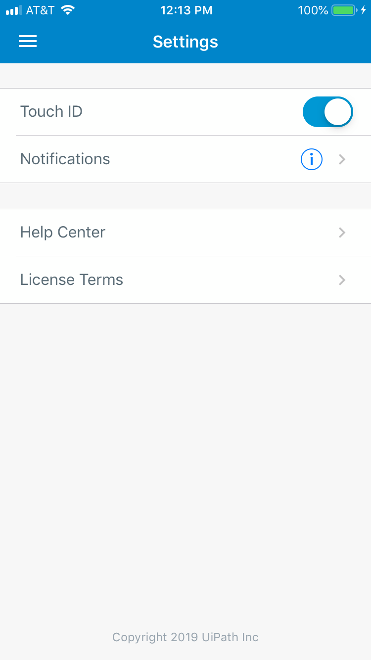

To access the Notifications page, select Settings menu > Notifications option.
