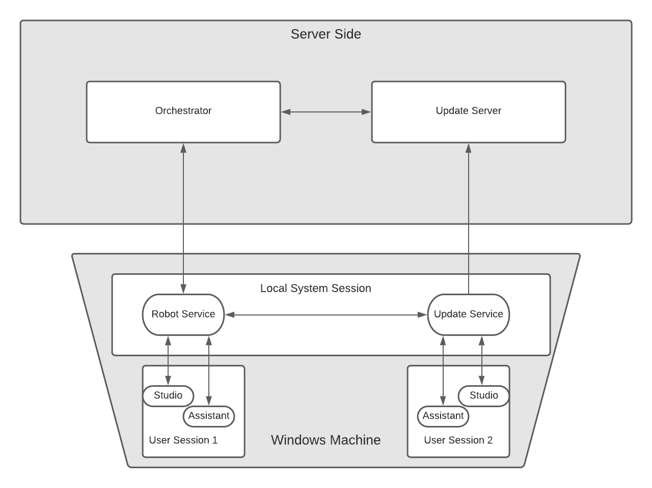

Service mode
In service-mode deployments, the robot service and update service both run in the local system account session.
Figure 1. Diagram of service-mode deployments
User mode
In user-mode deployments, the robot service runs in the user session and the update service runs in the local system account session.
When Robot and Studio are deployed in user mode, sending the update command to one Robot on the machine affects all users on that specific machine.
Figure 2. Diagram of user-mode deployments

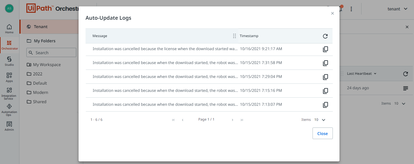

Update Logs
In the Orchestrator user interface, the update logs are available for failed and successful updates.
To view the update logs for a machine, in the tenant context, navigate to Machines, then select More Actions for the desired machine. In the More Actions menu, select View Installed Versions & Logs. In the Installed Versions & Logs grid, select View Auto-Update Logs for the desired entry.
Complete logs for the update are also available on the machine in the %localappdata%/Uipath/UpdateService/logs file.
When robots are deployed on virtual environments where the machines are cloned, the machine name, guid, drive id, and mac address are the same. This can cause conflicts as Orchestrator receives different update statuses from multiple machines with the same identifiers. In this scenario, the update status in Orchestrator is shown based on the last machine that connected. This can also impact orchestrator logs, as multiple machines have the same identifiers, duplicate logs can appear.

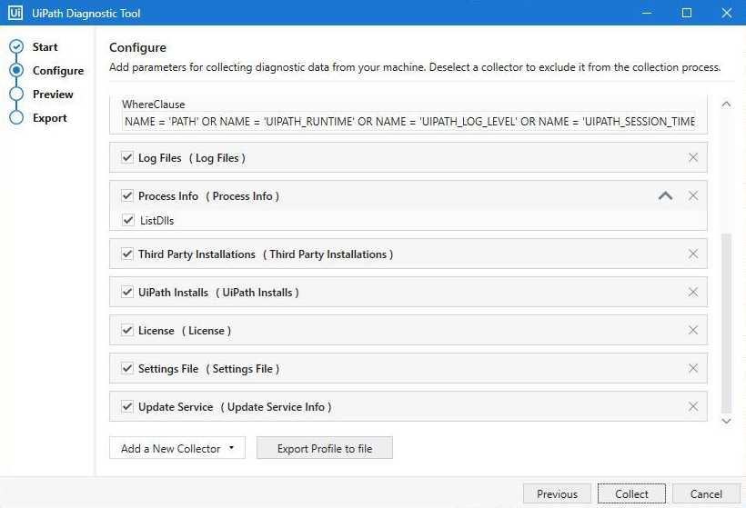

Collecting Error Logs
When an update fails, you can use the Diagnostic Tool to collect logs that you can send to our Support Team for further investigation of the specific error.

- Update Logs
