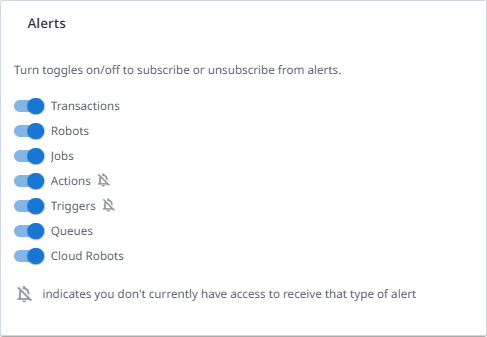

Subscribing or Unsubscribing from Alerts
You have the possibility to subscribe or unsubscribe from alerts on the Profile page. A toggle is available for each component: Transactions, Robots, Jobs, Actions, Triggers, Queues, and Cloud Robots.
If you are subscribed to alerts, they appear in the Alerts notification panel and you can view their details on the Alerts page. If you unsubscribe, you cannot see alerts related to the components for which you unsubscribed in either place.
If you don't have at least View permissions on a component, the no alert no_alertsno_alerts icon is displayed next to it and you don't receive any of the corresponding alerts, even if the toggle is switched on.

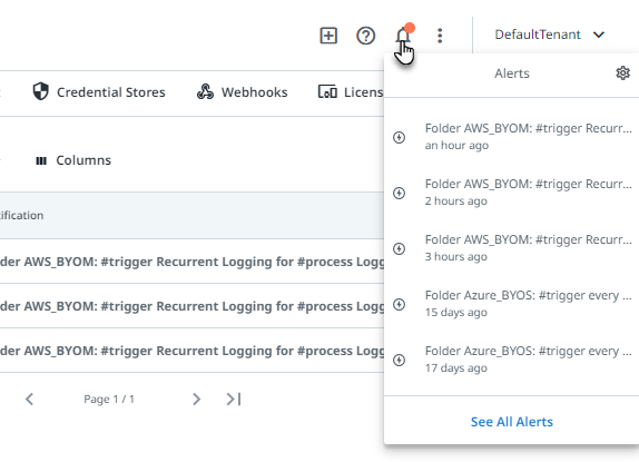

When new alerts are generated, a red badge appears on the Alerts icon in the top right:
Click the icon to open the Alerts panel, where you can view the five most severe alerts:
The notification panel displays a maximum of 5 alerts ordered according to severity and creation time. Higher severity alerts are displayed first; if there are several alerts with the same severity, the latest ones are displayed first.
To remove an alert from the Alerts panel, you must mark it as read from the Alerts page.
From the notification panel, you can navigate to:
  • the Alerts page by clicking See All Alerts at the bottom
  • to your Profile page where you can subscribe or unsubscribe from alerts by clicking Open Alerts Preferences in the top right corner of the panel.

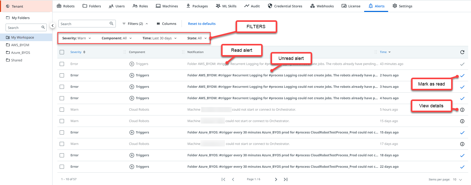

Viewing Alerts
You can view all alerts to which you have access on the Alerts page, which you can access by going to Tenant > Alerts.

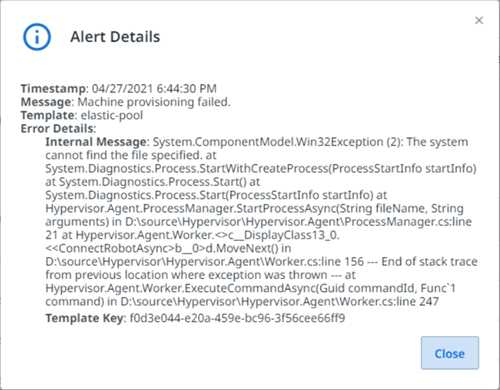

Viewing Alert Details
If you want to learn more about an alert, click the info icon at the right end of the row to open the Alert Details window:
By exception, alerts for the Triggers component do not have any further details so there is no info icon available for them.

When filtering the Alerts page according to the Severity level, please note that all greater severity levels are also displayed. For example, if you select Warn, messages are going to be displayed for the Warn, Error and Fatal severity levels.
The default value of the filter is Info. This means that removing all filters displays alerts having Info severity and above.
