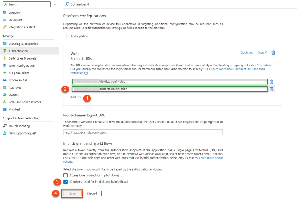

  3. Go to the Authentication page of your app:
    1. Under Redirect URIs, select Add URI to add a new entry.
    2. Add https://{yourDomain}/portal/testconnection to the Redirect URIs list.
    3. At the bottom, select the ID tokens checkbox.
    4. Select Save.

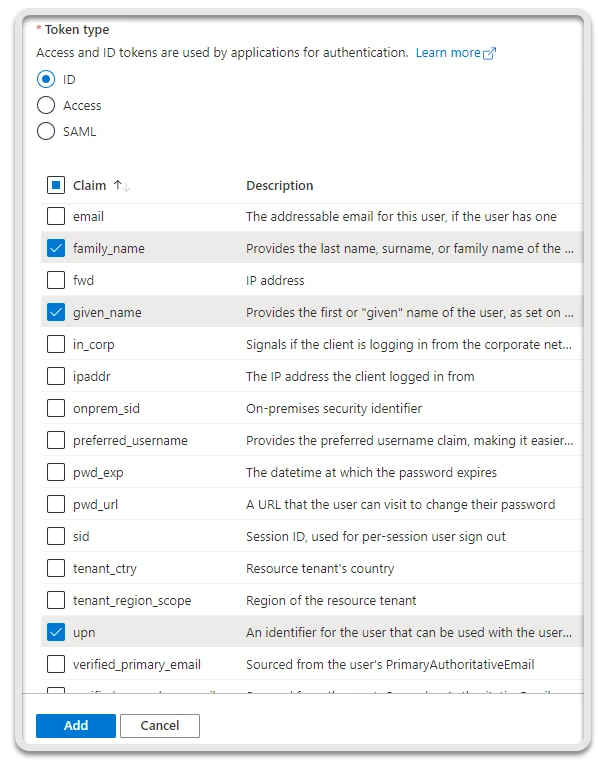

  4. Go to the Token configuration page.
  5. Select Add Optional Claim.
  6. Under Token type, select ID.
  7. Select the checkboxes for family_name, given_name, and upn to add them as optional claims:
