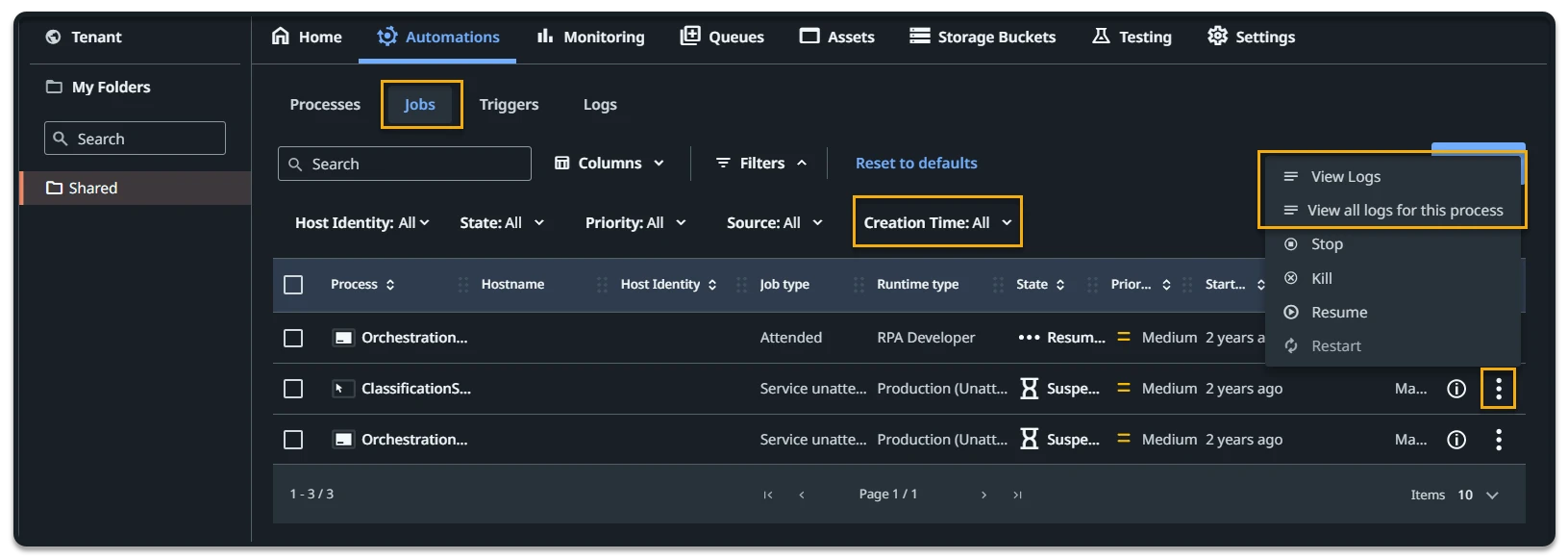

From the Jobs page, for an indicated job:
- Select the corresponding More Actions button.
- Select View Logs, to display the list of all logs for the selected job.

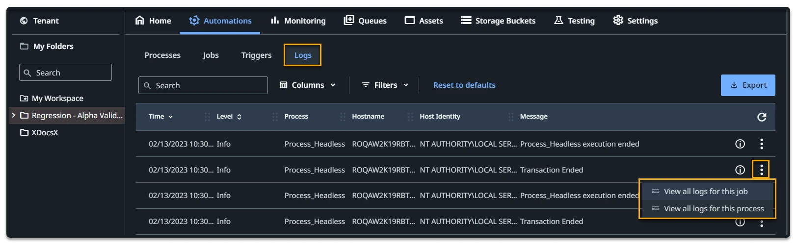

From the Logs page, for an indicated job:
- Select View all logs for this job, to display the list of all logs for the same job.
- Select View all logs for this process, to displays the list of all logs for the parent process, across all executed jobs.
Figure 1. Accessing logs from the Jobs page
Figure 2. Accessing logs from the Logs page
