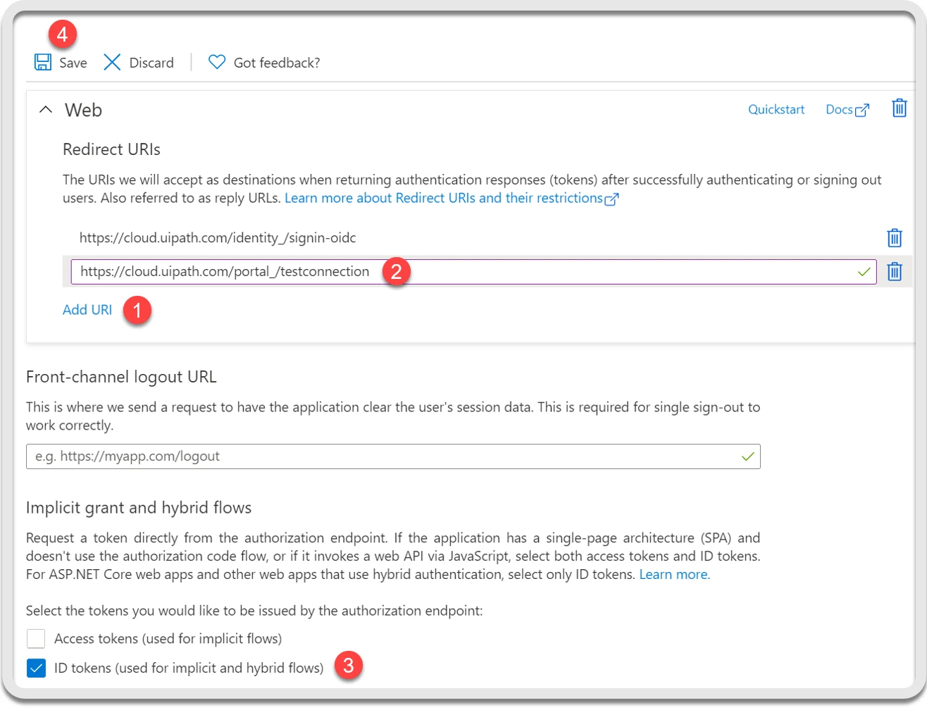

  3. Go to the Authentication page of your app:
    1. Under Redirect URIs, click Add URI to add a new entry.
    2. Add https://{baseURL}/portal_/testconnection to the Redirect URIs list.
    3. At the bottom, select the ID tokens check box.
    4. Click Save along the top.

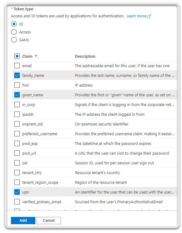

  4. Go to the Token configuration page.
  5. Select Add Optional Claim.
  6. Under Token type, select ID.
  7. Select the check boxes for family_name,given_name, and upn to add them as optional claims:

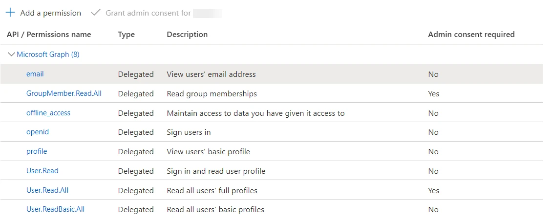

  8. Go to the API permissions page.
  9. Click Add permission and add the following delegated permissions from the Microsoft Graph category:
    PermissionWhat it allows you to doWhat we do with it
    email, openid, profile, offline_access, User.ReadAllows AAD to issue a user token to the system applicationAllow users to log into the system using an AAD login. This permits us to keep our user object updated, ensuring consistency of these attributes.
    User.ReadBasic.AllReads basic properties of all users in the directory that the logged in user is allowed to seeWhen a user assigns permissions to other users in the directory to their resources, they are able to search these users. The functionality for access management/authorization are in the system user experience.
    User.Read.All (requires admin consent)Reads all user properties in the directory that the logged in user is allowed to seeYour administrator may want to import these additional user properties to configure permissions or display custom information inside the system services. For Automation Hub, customers looking to obtain the full set of attributes from AAD, it is necessary to grant the User.Read.All permission to the app.
    GroupMember.Read.AllReads the group memberships of all the users that the signed in user has access toIf your organization is using groups to manage permissions in the system, then the platform needs to be able to list all the groups and discover the members of a group; that allows both management and enforcement of group assigned permissions.
    To learn more about UiPath's access with these permissions, see our Encryption documentation.
    • OpenId permissions - email, openid, offline_access, profile;
    • Group member permissions - GroupMember.Read.All;
    • User permissions - User.Read, User.ReadBasic.All, User.Read.All (requires administrative consent).
  10. Select the Grant admin consent check box.

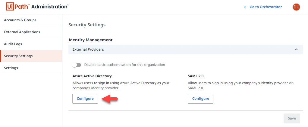

  1. Log in to the Management portal as an administrator.
  2. Select Security Settings.
  3. In the External Providers section, under Azure Active Directory, select Configure.
    The Configure Azure Active Directory side panel opens.
  4. Fill in the fields with the information received from your Azure administrator.
  5. Select the checkbox I understand & accept added users and Azure AD users with matching email addresses will have their accounts linked.​
    This is required because after you save your changes, matching accounts are automatically linked.
  6. When prompted, sign in with your Azure AD account.
    A successful sign-in indicates that the integration has been configured correctly. In case it fails, ask your Azure administrator to check that Azure is correctly configured and then try again.
  7. Select Save.
