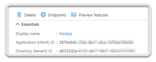

Open the application's Overview page, copy the Application (client) ID and Directory (tenant) ID, and save them for later use:

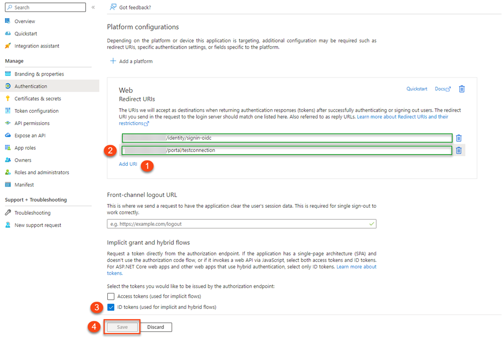

Go to the Authentication page of your app:
Under Redirect URIs, select Add URI to add a new entry.
Add
https://{yourDomain}/portal/testconnectionto the Redirect URIs list. -
At the bottom, select the ID tokens checkbox.
Select Save.

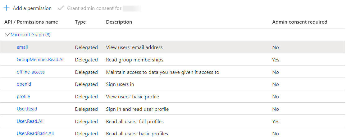

Go to the API permissions page.
Select Add permission and add the following delegated permissions from the Microsoft Graph category:
OpenId permissions -
email,openid,offline_access,profile -
Group member permissions -
GroupMember.Read.All -
User permissions -
User.Read,User.ReadBasic.All,User.Read.All(requires administrative consent)The following table describes the API permissions:
Permission What it allows you to do What we do with it email,openid,profile,offline_access,User.ReadAllows Microsoft Entra ID to issue a user token to the system application Allow users to log into the system using a Microsoft Entra ID login. This permits us to keep our user object updated, ensuring consistency of these attributes. User.ReadBasic.AllReads basic properties of all users in the directory that the logged in user is allowed to view When a user assigns permissions to other users in the directory to their resources, they are able to search these users. The functionality for access management/authorization are in the system user experience. User.Read.All(requires admin consent)Reads all user properties in the directory that the logged in user is allowed to view Your administrator may want to import these additional user properties to configure permissions or display custom information inside the system services. For Automation Hub, customers looking to obtain the full set of attributes from Microsoft Entra ID, it is necessary to grant the User.Read.Allpermission to the app.GroupMember.Read.AllReads the group memberships of all the users that the signed in user has access to If your organization is using groups to manage permissions in the system, then the platform needs to be able to list all the groups and discover the members of a group. That allows both management and enforcement of group assigned permissions.
Select the Grant admin consent checkbox.
Note:The administrator consents on behalf of all users in the tenant active directory. This allows the application to access the data of all users, without users being prompted to consent. For more information about permissions and consent, refer to Microsoft's Microsoft Entra ID documentation.

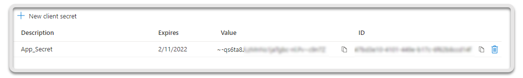

Go to the Certificates & secrets page to create a new client secret or a new certificate.
- Option 1. Client secret. For more information about client secrets, refer to Microsoft's documentation about Adding a new client secret.
Note:
The created client secret is not permanent. You must update the client secret after its validity period.
- Option 2. Certificate. The high-level steps for configuring certificates are described in . For more on certificates, see Setting and retrieving a certificate from Azure Key Vault in the Microsoft documentation.
