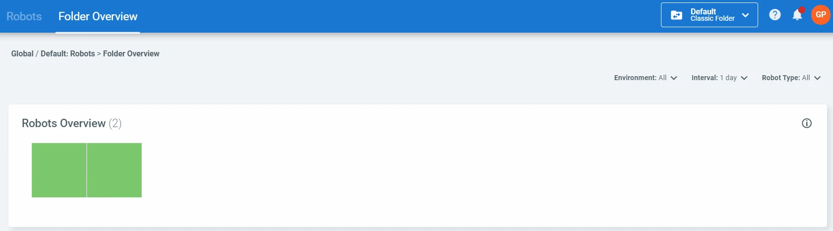

Robots Overview​
Allows you to check the status of your Robots in detail so that you can assess if there are any problems that could impact the entire system.
Each color block represents a specific Robot from your instance. Hovering over a block displays the name of the corresponding Robot.
The total number of Robots is displayed in parentheses after the widget name. As the status changes, the chart gets updated and the color changes accordingly.
The various scenarios are represented with colored blocks and tooltips as follows:

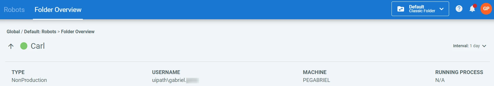

Individual View​
Displays information concerning one Robot, as selected by the user from the general view, specifically on the Robots Overview widget. Each widget in this view contains the exact same information as on the Robots page. Changing the properties there automatically causes the information here to update accordingly.
Filters​
Interval - allows you to control the granularity of the data, and display either the last hour or last day (last 24 hours) of the selected Robot's activity.
Header Details​
The name of the Robot is displayed at the top left of the page.
Right below the Robot's name and Interval filter, you can find the following information concerning the selected Robot:
  • Type - the Robot type;
  • Username - the username used to connect the Robot to Orchestrator;
  • Machine - the name of the machine on which UiPath Robot is installed;
  • Running Process - the name of the process that is being executed.
