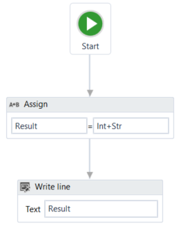

Example of Using a GenericValue Variable
To demonstrate how a GenericValue variable works, let us create an automation that performs different operations whose results depend on the way we define their expressions. We create two GenericValue variables of different data types and display the results in the Output panel.
- Create a new blank project.
- Create three GenericValue variables:
Int
,Str
, andResult
. - In the Default column for the
Int
variable, type 12, and for theStr
variable, type "34". The first variable is interpreted as an integer, while the second one is interpreted as a string.
- Add an Assign activity to the Designer panel and connect it to the Start node.
- In the Properties panel, in the To field, enter the
Result
variable. - In the Value field, type
Int
+Str
. - Add a Write Line activity and connect it to the Assign one.
- In the Properties panel, in the Text field, enter the
Result
variable.
The project should look as in the following screenshot.
- Press F5 to execute your automation. Note that, in the Output panel, the sum of the two numbers is displayed.
