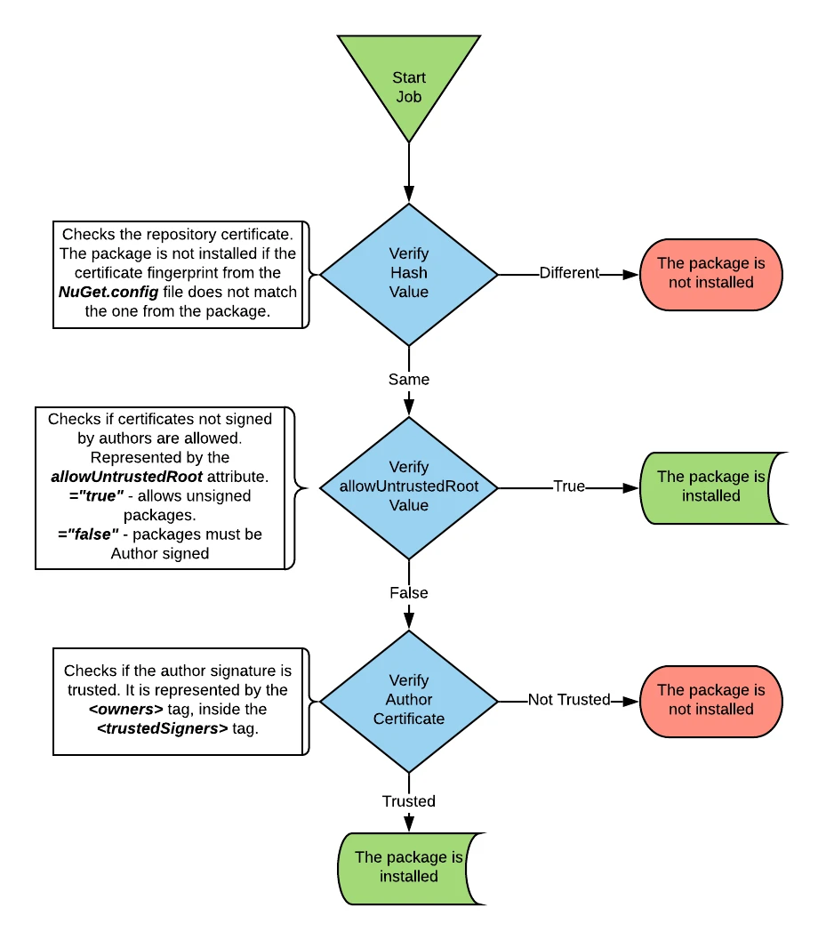

Adding a Trusted Repository
Adding a trusted repository is done roughly the same as adding an author, with the difference that the serviceIndex must also be added.
Below is an example of a trusted repository added to the NuGet.config file:
<trustedSigners>
<repository name="UiPath Repository" serviceIndex="https://uipath.repository">
<certificate fingerprint="1234512345123451234512345123123123123123123123123123112312312E5" hashAlgorithm="SHA256" allowUntrustedRoot="true" />
</repository>
</trustedSigners>
<trustedSigners>
</repository>
</trustedSigners>
Adding Trusted Owners
A repository may have multiple author-signed packages. In this case, the <owners> tag can be used for allowing only packages signed by trusted authors to be installed.
Add the trusted authors between the <owners> tags, as in the example below:
<trustedSigners>
<owners>Author1;Author2</owners>
</repository>
</trustedSigners>
<trustedSigners>
</repository>
</trustedSigners>

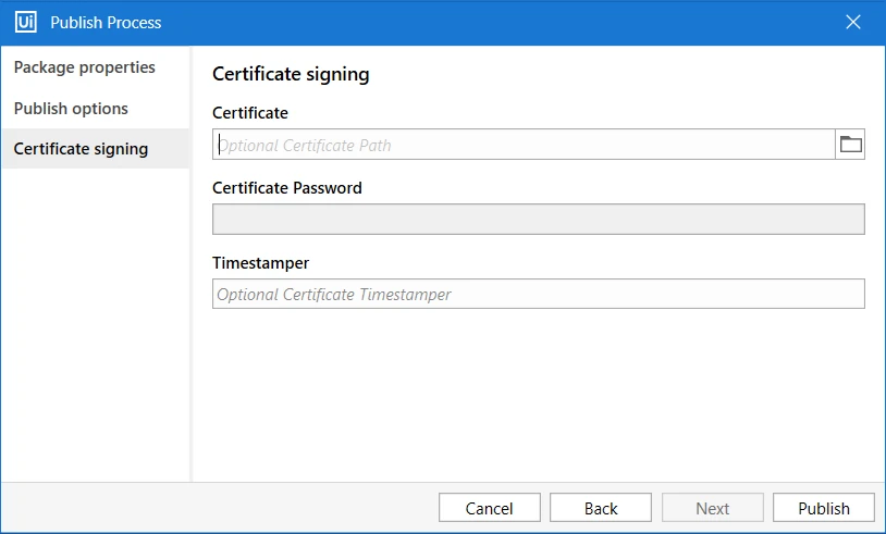

Signing a Package
In Studio, package signing can be done from the Publish window, the Certificate signing tab, for both processes and libraries.
In the Certificate signing tab, add the certificate path on your local machine. Use the
button to navigate to the path if needed. Only .pfx and .p12 certificate file formats are accepted. -
Next, type in the Certificate Password and add an optional certificate Timestamper if needed. Click Publish. The resulting
.nupkgfile is signed with a certificate and a timestamper, if indicated.
Timestamps are a secure way of keeping track of the date and time when a package was signed. To learn more about timestamping in the context of NuGet package signing, check out this link.
If the certificate timestamper is invalid, an error message containing the project name is thrown in Studio after clicking the Publish button. A similar error message is also logged in the Output panel.
