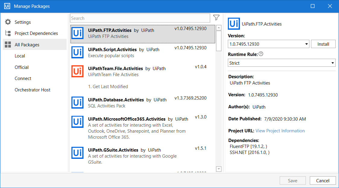

  1. In the Manage Packages window select the All Packages category. This opens a list of all packages gathered from your feeds.
    docs image
  2. Locate the package you want to install. Please note that the activities packages and versions that are available depends on the compatibility selected for the project.

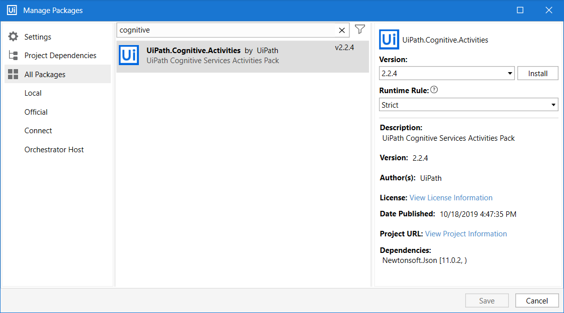

You can:
  • Scroll down the list to find the package.
  • Search for the package by typing part of its name or description in the search bar.
  • Filter the list by clicking the Filter docs image icon next to the search bar, and then selecting only the options you want to see:

  1. Select an activity package to view its description, version, dependencies, the project URL and the date when it was published.
  2. Click on the drop-down list next to Version to pick a version of the package, and then set a Runtime Rule. To read more about runtime rules for project dependencies check the Managing Dependencies page.
  3. Click on the Install button. Alternatively, click on the docs image icon next to the package name to mark it with the docs image icon, making it ready for installation.
