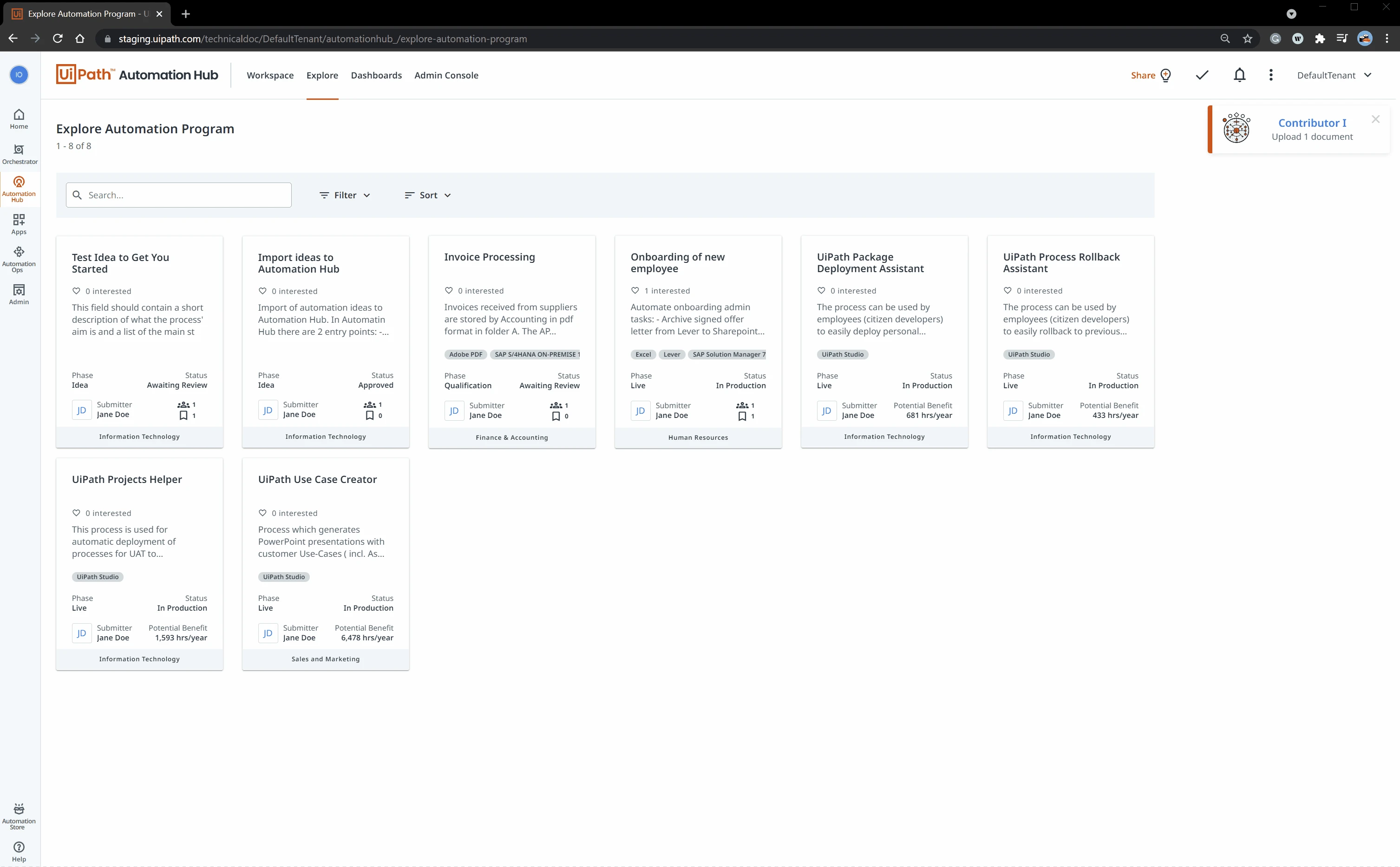

Create and export the PDD by accessing your Automation Hub tenant and opening one of the below locations:
  • The page displayed after an Employee-driven Assessment was submitted.
    1. Submit an Employee-driven Assessment and add the idea's details.
    2. After submitting it, the Automation Score page is displayed.
  • Automation profile page Documentation.
    1. Under Automation Files click Create New Process Document with Task Capture.
    2. Click open the app hyperlink.
To directly export a PDD to Automation Hub, please launch Task Capture from Automation Hub first and then attempt using the Publish to Automation Hub option. Otherwise, the Publish to Automation Hub option will not be available.
If you created a .SSP document using Task Capture you can import it in an Automation Hub idea by accessing its Documentation area and importing the file as a Task Capture file. For details please check this page.
The documentation created in Task Capture is exported to the Automation Hub location you select when initiating the process.

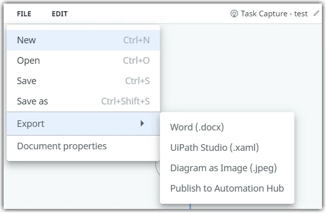

  1. In Task Capture access File and from Export select Publish to Automation Hub.
  2. The Uploading pop up page is displayed. The recorded .ssp, .docx, .xaml and .jpg files are compressed into a ZIP archive and uploaded to Automation Hub > automation profile page > Documentation.

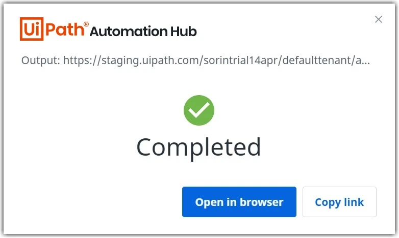

  3. A confirmation message is displayed once the ZIP archive is uploaded. You have the following options:
    • Copy link - copy the Automation Hub location path of the .ZIP archive.
    • Open in browser - open the Automation hub page where the process doc file is stored.

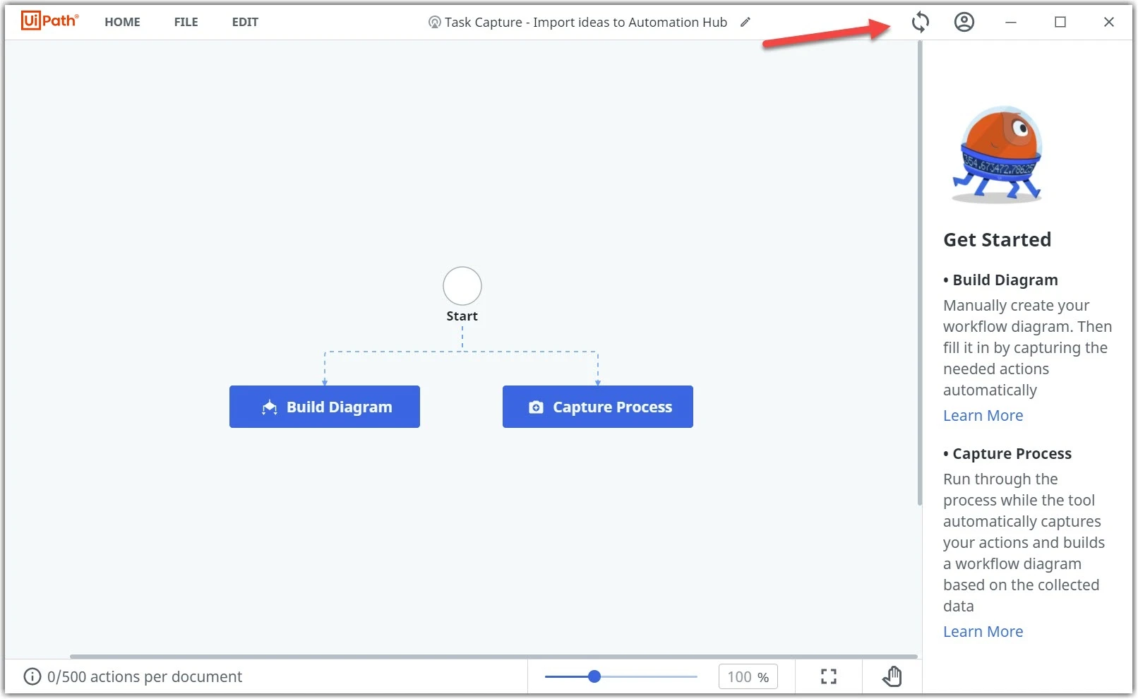

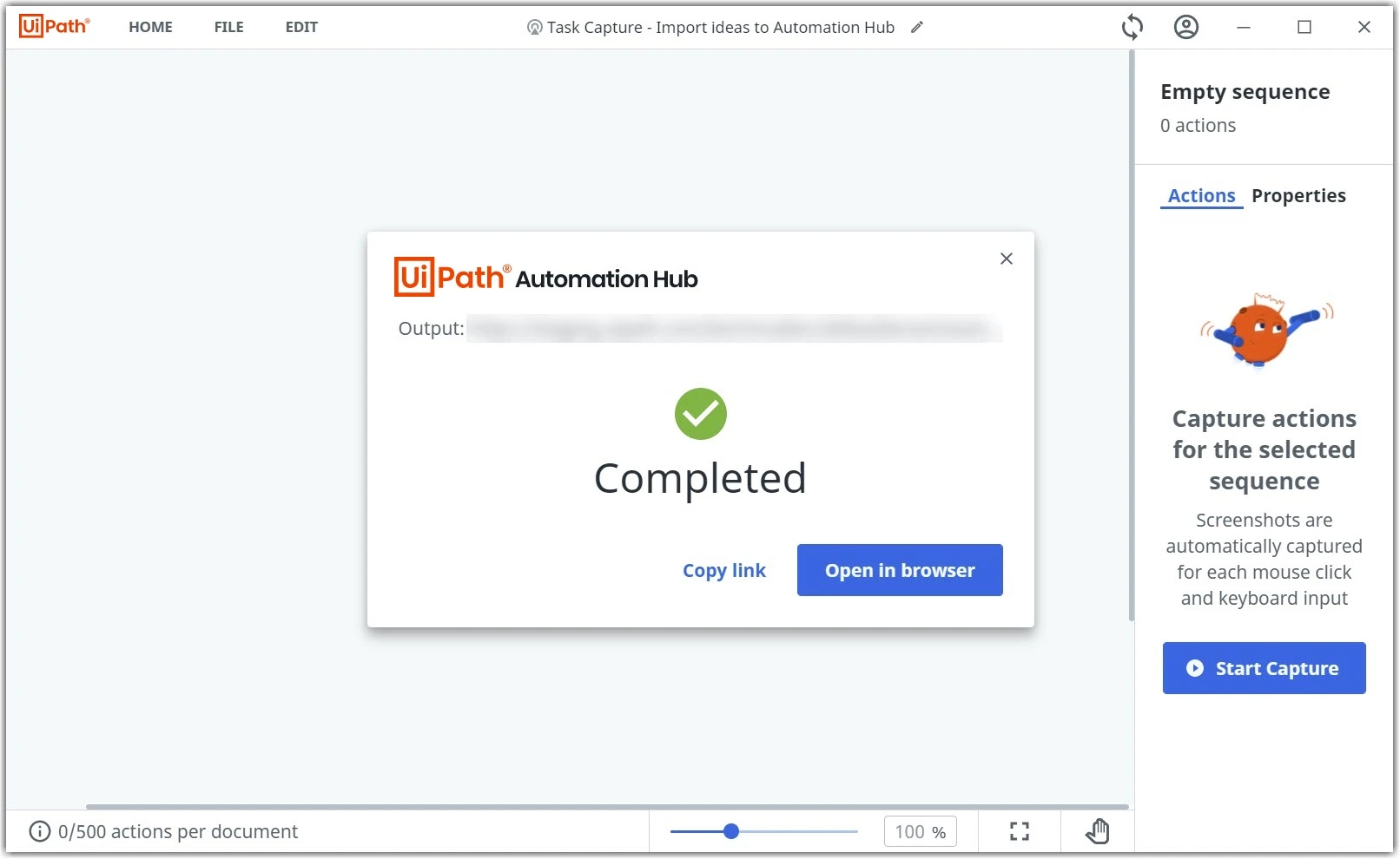

Exporting via sync button​
Another way you can export the created workflow diagram is by using the sync button from the header pannel.
After clicking the icon, the project is exported to your Automation Hub location and a Completed message is displayed to confirm.
