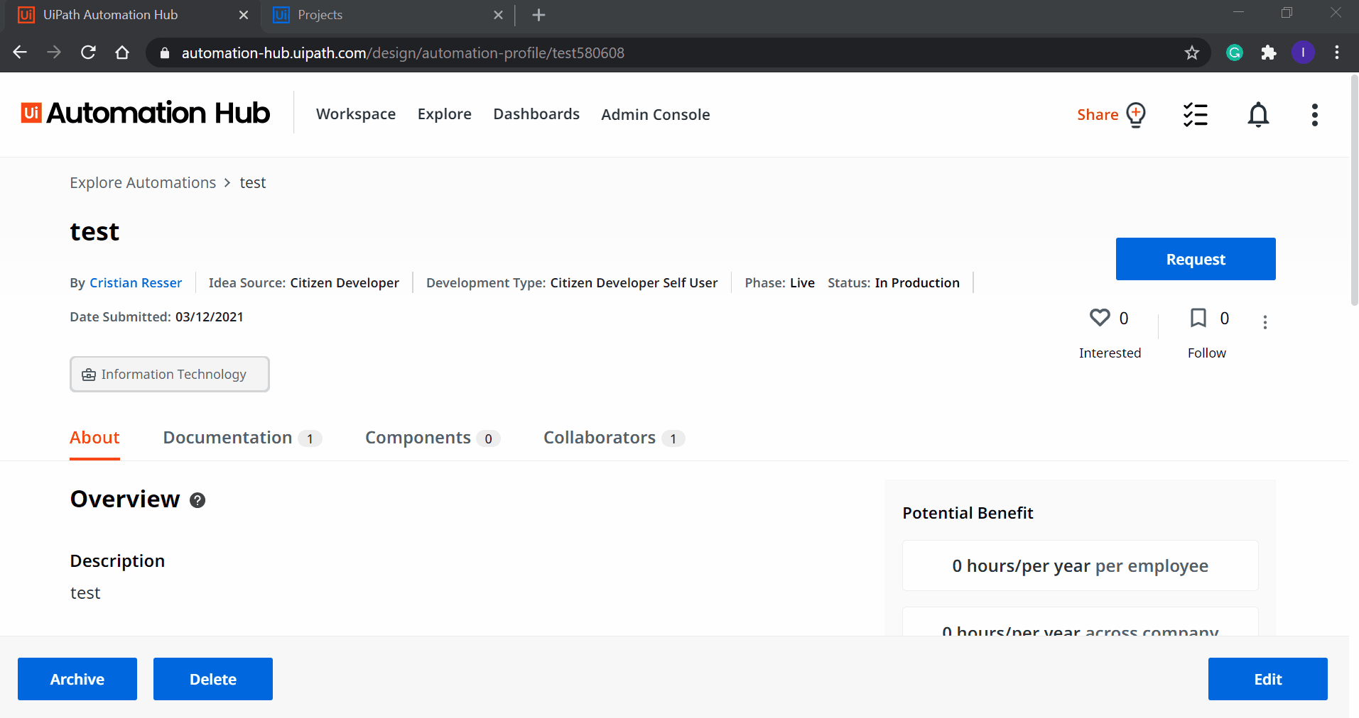

Automation profile page Documentation.
- Under Automation Files click Create New Process Document with Task Capture.
- Click open the app hyperlink.

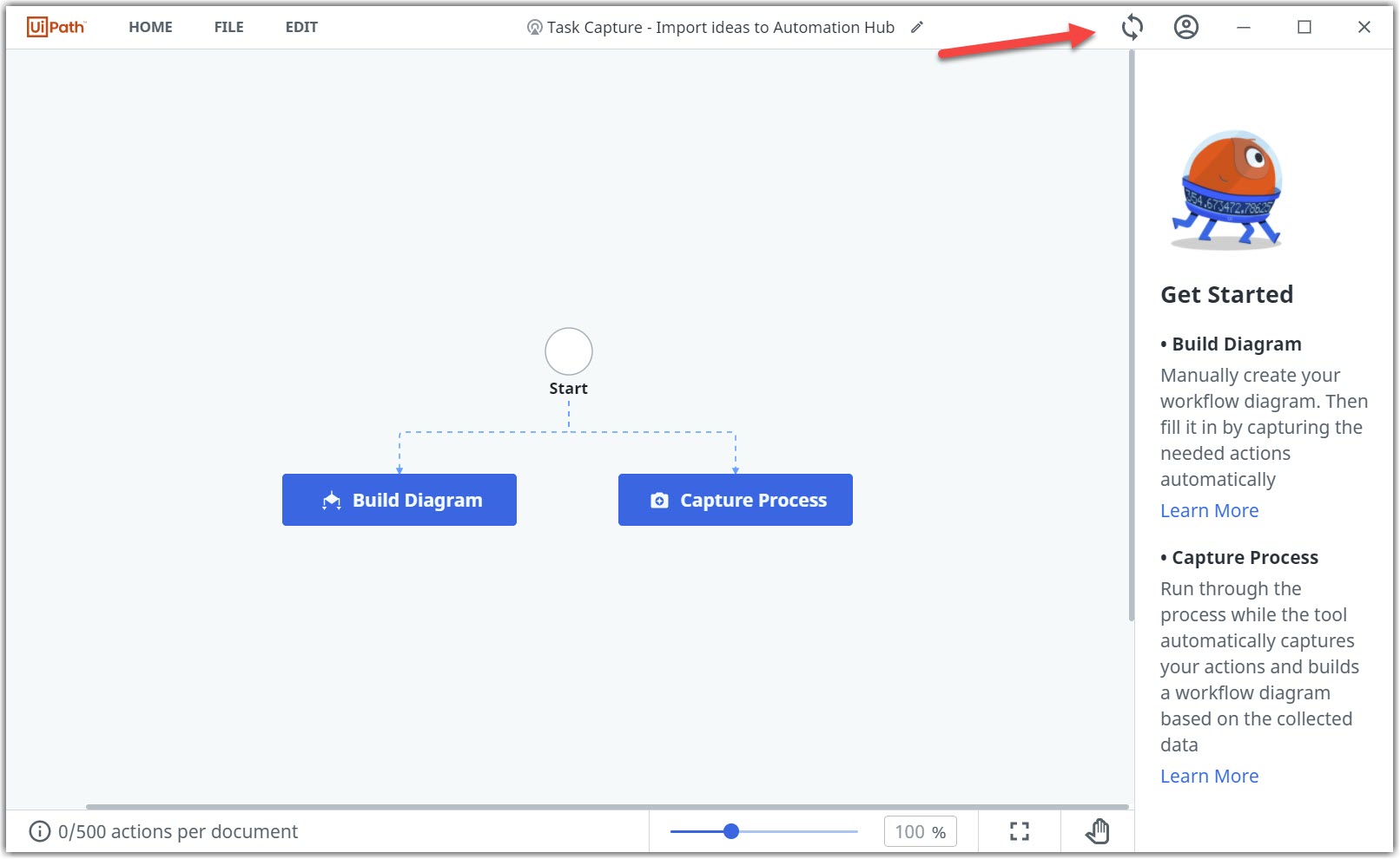

Click Open Task Capture.
Note: If your Task Capture version is lower than 20.4 first upgrade it by using the Download drop-down list. Otherwise, Task Capture will not be displayed when clicking open the app hyperlink. - Select the type of process you want to record.
Start recording your process.
By default, documents captured using the Create New Process Document with Task Capture option have the same name as the idea from where the tool was launched. To change the name of the process click the Edit icon displayed as a pencil. This is available on the upper part of the screen in the middle of the application top panel. Once the Rename Process Document pop-up is displayed type in the new name for your process and click Submit.

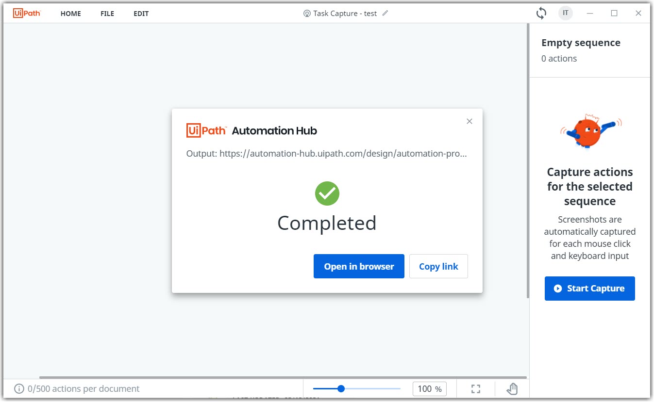

In Task Capture access File and from Export select Publish to Automation Hub.
- The Uploading pop up page is displayed. The recorded .ssp, .docx, .xaml and .jpg files are compressed into a ZIP archive and uploaded to Automation Hub > automation profile page > Documentation.
A confirmation message is displayed once the ZIP archive is uploaded. You have the following options:
- Copy link - copy the Automation Hub location path of the .ZIP archive.
Open in browser - open the Automation hub page where the process doc file is stored.
