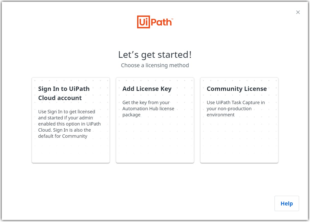

If the above is not your case, opening Task Capture displays the activation window offering you to select one of the three options available.
UiPath Cloud account
You can activate Task Capture by using the UiPath Cloud account. To do this follow the steps below:
- Select the option to Sign In to UiPath Cloud account.
UiPath Cloud account activation

The recommended activation approach for Task Capture is Standalone, with a standalone license code.
- The default browser opens and redirects to cloud.uipath.com where you need to sign in and select your organization.
- After a successful sign in, a dialog asks to Open Task Capture.
- Task Capture is activated now and information about the license is displayed on the bottom left corner of the application.
Activate Standalone License
If you have a standalone license code, activate Task Capture by selecting this option. This type of license activates the Enterprise Edition of Task Capture.
