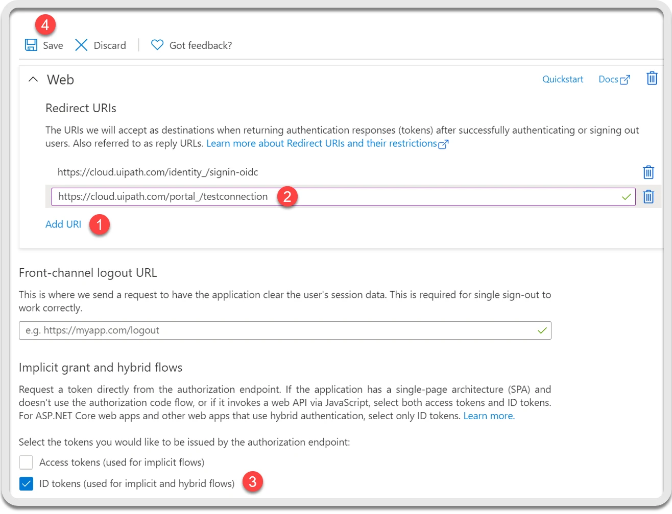

Go to the Authentication page of your app:
Under Redirect URIs, click Add URI to add a new entry.
Add
https://{baseURL}/portal_/testconnectionto the Redirect URIs list. -
At the bottom, select the ID tokens check box.
Click Save along the top.

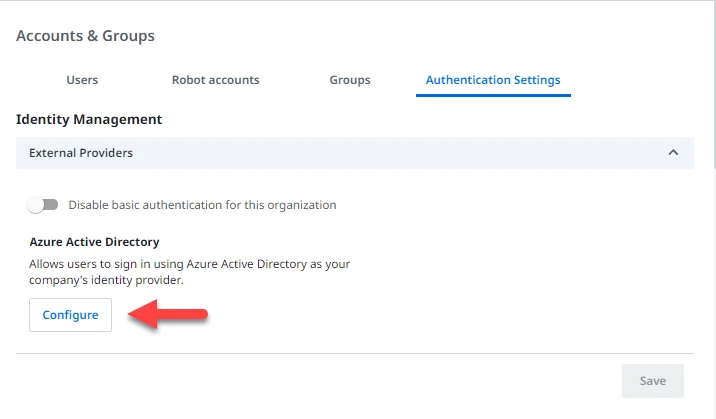

To activate the Azure AD integration, do the following in Orchestrator:
Log in to the Management portal (
https://OrchestratorUR:/identity/management) as an administrator. -
On the Accounts & Groups page, select the Authentication Settings tab.
In the External Providers section, click Configure under Azure Active Directory:
The Configure Azure Active Directory panel opens at the right of the window.
Fill in the fields with the information received from your Azure administrator.
Select the check box.
This is required because after you save your changes, matching accounts are automatically linked.
Click Save.
The integration is now active for your organization.

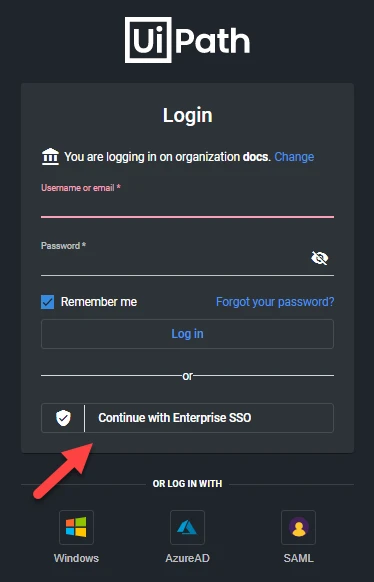

Initial sign in: For the permissions assigned to Azure AD users and groups to apply, users must sign in at least one time. We recommend that, after the integration is running, you communicate to all your users to sign out of their UiPath account and sign in again with their Azure AD account. They can sign in with their Azure Ad account by:
navigating to the organization-specific URL, in which case the sign in type is already selected;
Note:The URL must include the organization ID and end in a forward slash, such as
https://{baseURL}/orgID/. -
by selecting Enterprise SSO on the main login page.
Note:Make sure you provide your organization-specific URL for Orchestrator to all your users. Only organization administrators can see this information in Orchestrator.
