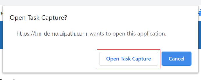

  1. Once you clicked the Document with Task Capture option, the Task Capture in-app pop up is displayed. Click Open Task Capture.
  2. Start recording your process.
