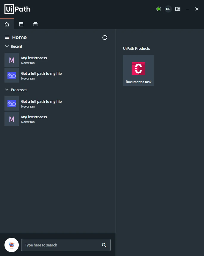

Download a partir do UiPath Assistant​
Starting with 2021.10 release, users can download and install the Task Capture desktop application directly from the UiPath Assistant.
This is done by expanding the right side panel of the Assistant, and clicking on the Document a task tile from the UiPath Products section.

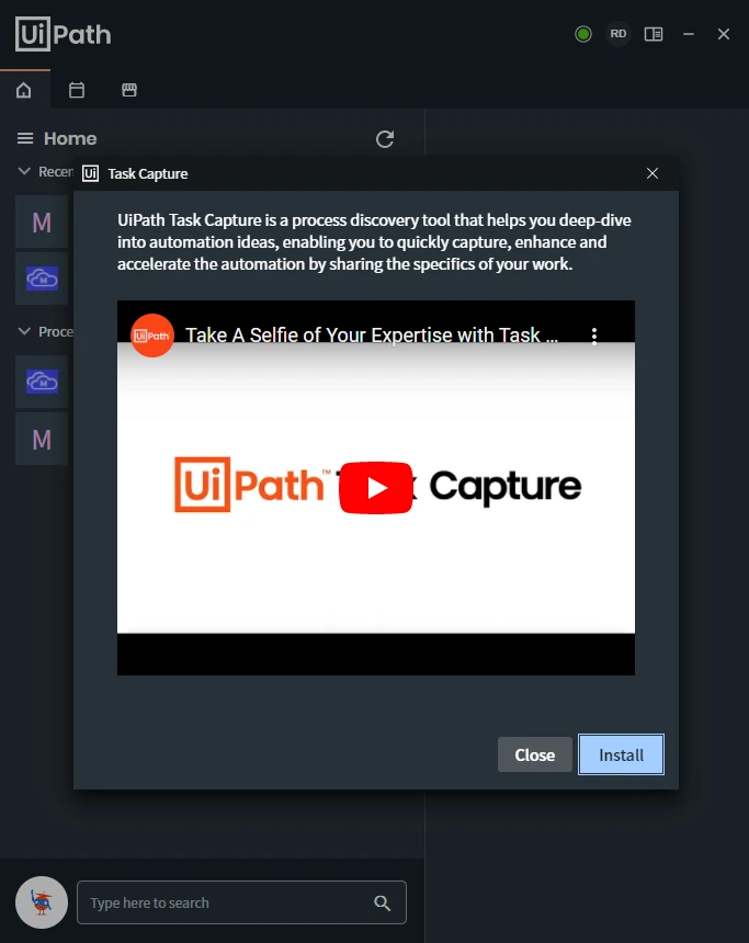

If the Task Capture application is not installed on the machine, a pop-up dialog appears with a short description and video about the application and the user is able to install it from here by clicking on the install button. After the application is installed, it should automatically sign in the user using the same account that is active in Assistant. Otherwise, the user can acquire a license by following the steps from Activating Task Capture.
Observação:
Dependendo das políticas na máquina, os direitos de administrador podem ser necessários para instalar o aplicativo do Task Capture.
If Task Capture is already installed on the machine, clicking on the Document a Task tile in the Assistant opens the application as usual.
