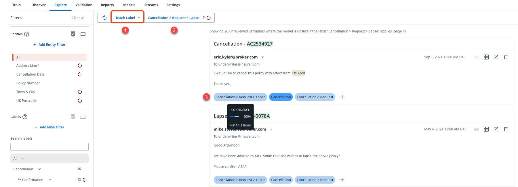

Key steps​
  1. Select Teach Label from the dropdown menu as shown in the following image.
  2. Select the label you wish to train, where the default selection in Teach mode is to show unreviewed messages.
  3. You will be presented with a selection of messages where the model is most confused as to whether the selected label applied or not. This means you should review the predictions and apply the label if they are correct, or apply other labels if they are incorrect.
    Note:
    • Predictions will range outwards from ~50% for data with no sentiment and 66% for data with sentiment enabled.
    • Make sure you apply all other labels that apply as well as the specific label you are focusing on.
You should use this training mode as required to boost the number of training examples for each label to above 25, so that the platform can then accurately estimate the performance of the label.

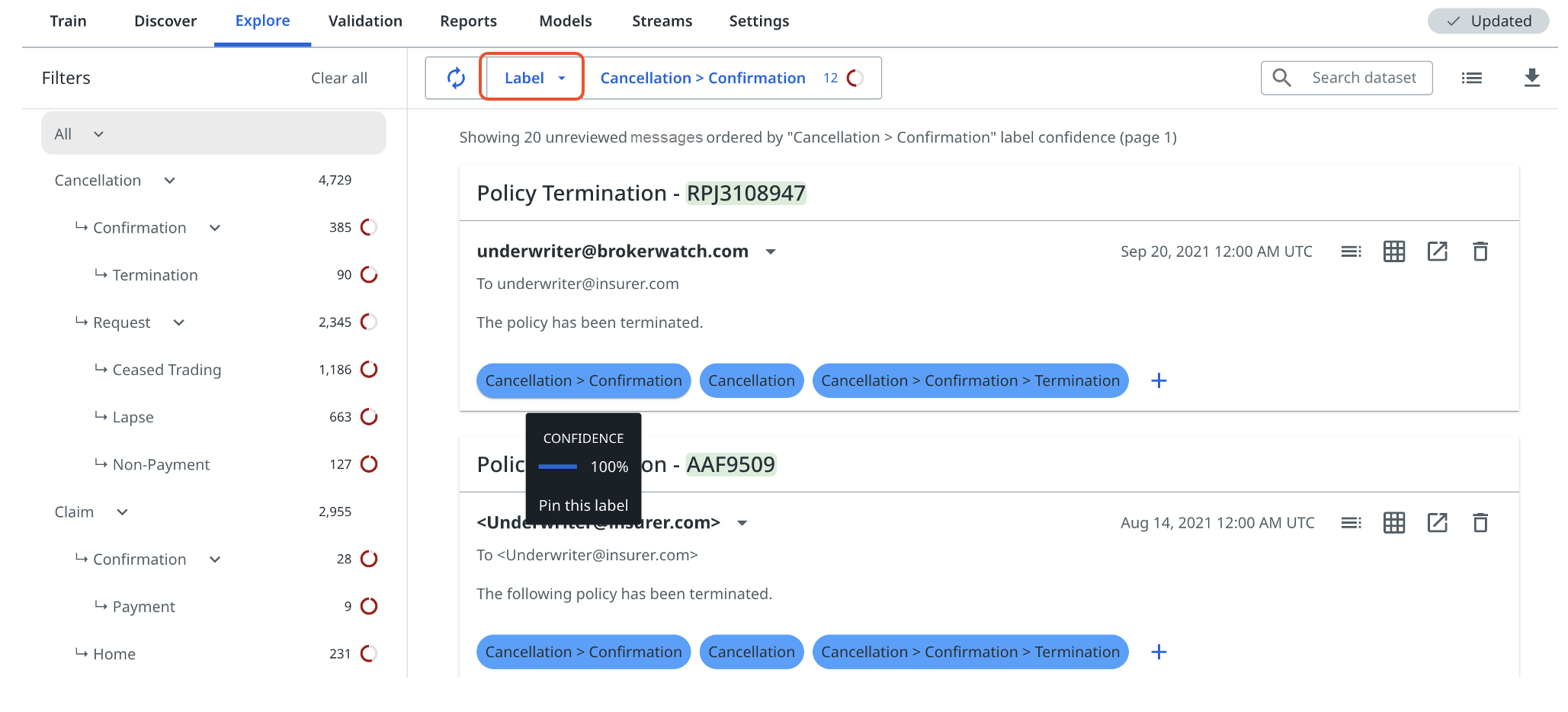

Option 2 - Label​
Although training using Label is not one of the main steps outlined in the Explore phase, it can still be useful in this phase of training. In Label mode, the platform shows you messages where that label is predicted in descending order of confidence, that is, with the most confident predictions first and least confident at the bottom.
However, it is only useful to review predictions that are not high-confidence, above 90%. This is because when the model is very confident, that is, above 90%, then by confirming the prediction you are not telling the model any new information, it is already confident that the label applies.
Look for less confident examples further down the page if needed. Although, if predictions have high confidences and are wrong, then make sure to apply the correct labels, thus rejecting the incorrect predictions.
