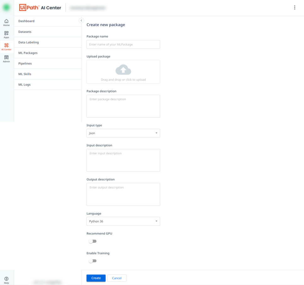

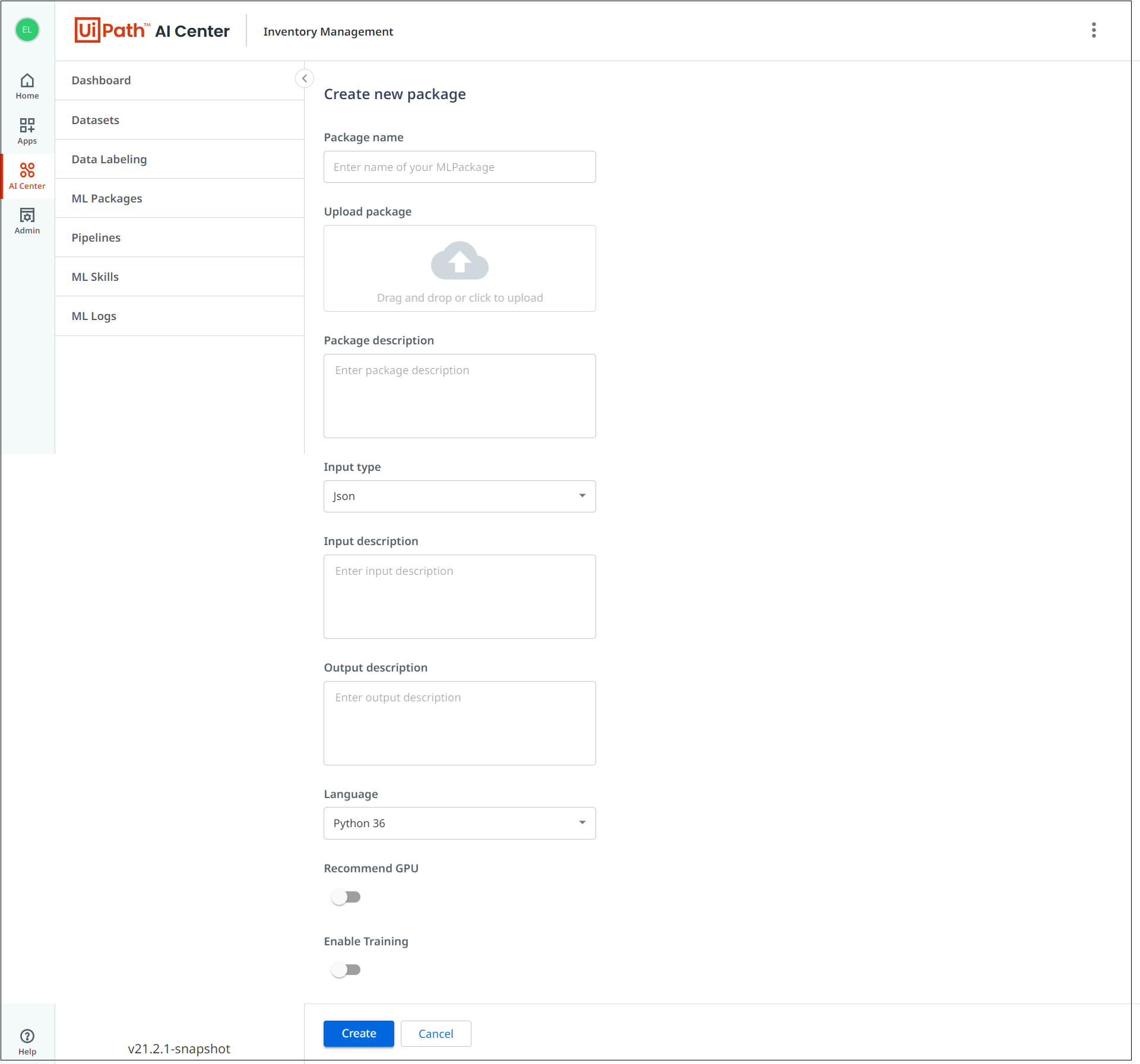

- In the ML Packages page, click the Upload zip file button. The Create New Package page is displayed.
- In the Create New Package page, enter a name for your package.
- Click Upload Package to select the desired
.zip
file or drag & drop the package.zip
file into the Upload package field. - (Optionally) Provide a clear description of the model.
The description is displayed while deploying a new skill based on this model, as well as on the ML Packages page. - Select the input type from the drop-down. The possible options are:
json
file
files - (Optionally) Enter a clear description of the input expected by the model.
- (Optionally) Enter a clear description of the output returned by the model.
These descriptions are visible to RPA developers using the ML Skill Activity in UiPath Studio. As a good practice, we recommended showing an example of the input and output formats to facilitate communication between data scientists and developers. - Select the development language of the model from the drop-down. The possible options are:
Python 3.6
Python 3.7
Python 3.8
Python 3.8 OpenCV - Select whether the machine learning model requires a GPU, by default it is set to No. This information is surfaced as a suggestion to when a skill is created from this package.

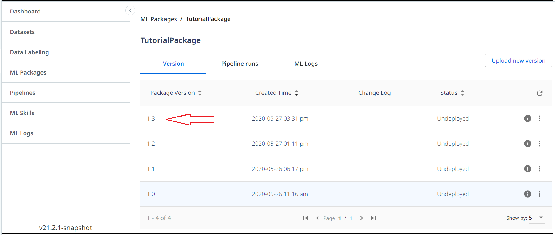

In the Version tab, view its details: package version, creation time, change log, status, whether or not training is enabled, whether or not recommended GPU is enabled, and arguments.
You can find more information on each entry in the ML Packages Version by clicking on the icon and then Details. A dialog box will be displayed with all the information on the package version.

ML Package Versions Created by Training Pipelines
When a training pipeline or a full pipeline executes successfully on a package version, a new minor version is created. For example, if I have uploaded a package (version 1.0), and start a training pipeline, version 1.1 is displayed after completion in the ML Package Details page as below:
