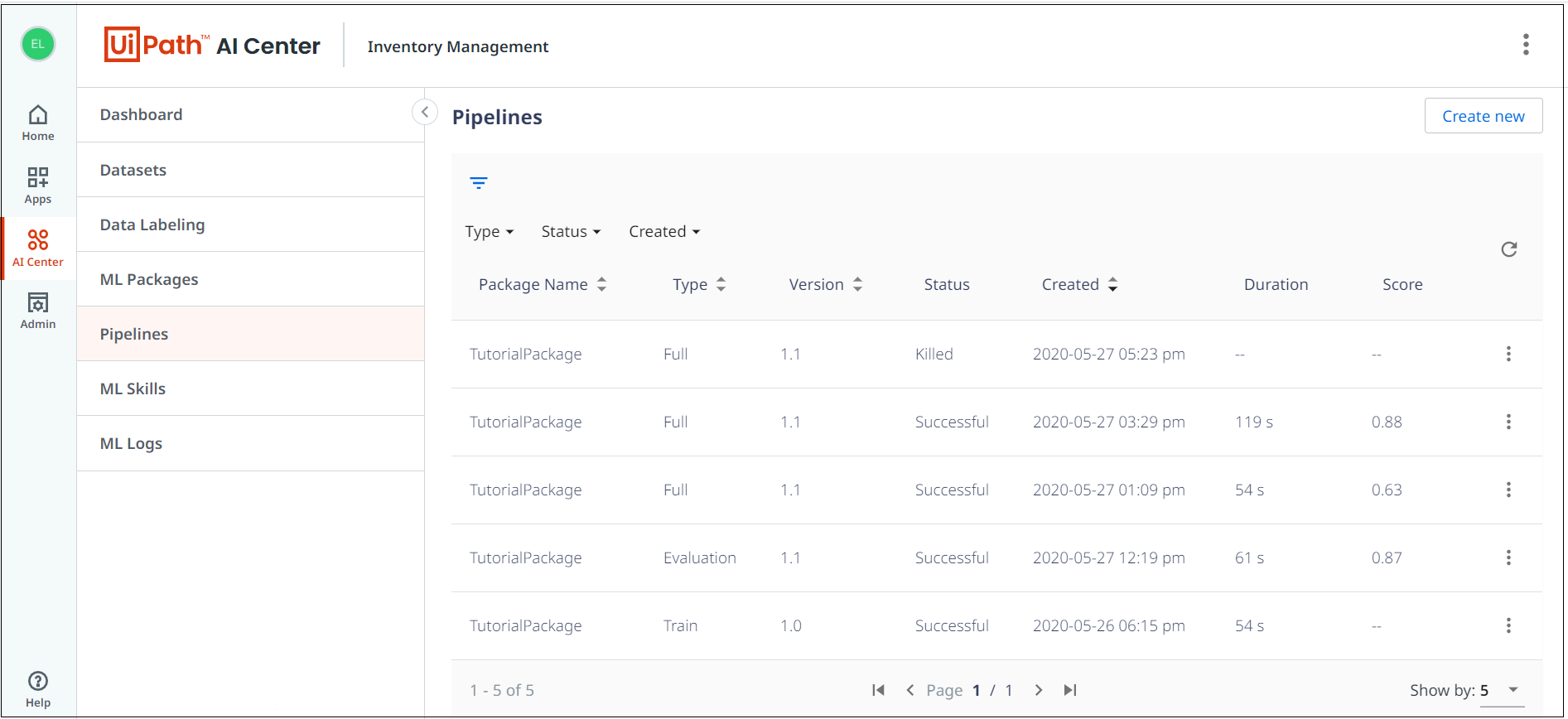

The Pipelines page, accessible from the Pipelines menu after selecting a project, enables you to view all the pipelines within that project, along with information about their type, associated package and package version, status, creation time, duration, and score. Here you can create new pipelines, access existing pipelines' details, or remove pipelines.

Pipeline status
A pipeline run can be in one of the following statuses:
  • Scheduled –A pipeline that has been scheduled to start in the future (for example at 1am every Monday). When the date-time set for a pipeline to start running is reached, the pipeline is queued to run.
  • Packaging – A pipeline that has started building the docker image on which the job itself will be executed. If this is the first time you are training this specific version of the ML Package this can takes up to 20 minutes.
  • Waiting for resources – A pipeline that is looking for available license to execute. Pipeline checks every 5 minutes if new license is available (this will happen if you remove running ML Skills or if another Pipeline completed) and will start as soon as this is the case.
  • Running – A pipeline that has started and is executing.
  • Failed – A pipeline that failed during execution.
    Note: Pipelines can fail if the dataset set size exceeds the 50 Gb limit.
  • Killed – A pipeline that was executing until the user explicitly called for its termination.
  • Successful – A pipeline that completed execution.
    Note: Pipelines are automatically killed after seven days to avoid being stuck for longer periods of time and consuming licenses.
