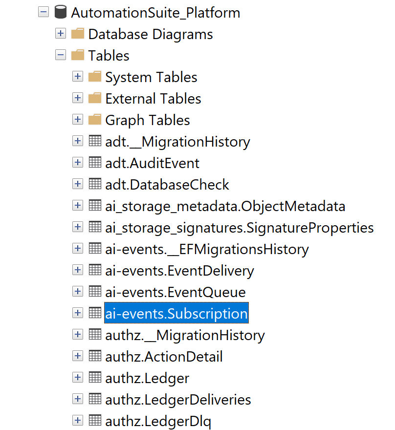

Connect to the Database Server of the Automation Suite environment: AutomationSuite_Platform > ai-events.Subscription.
Run the following commands on the table:
delete from [ai-events].[Subscription] where WebhookUrl like '%http://ai-helper%' delete from [ai-events].[Subscription] where WebhookUrl like '%http://ai-pkgmanager%' delete from [ai-events].[Subscription] where WebhookUrl like '%http://ai-deployer%' delete from [ai-events].[Subscription] where WebhookUrl like '%http://ai-trainer%' delete from [ai-events].[Subscription] where WebhookUrl like '%http://ai-appmanager%'delete from [ai-events].[Subscription] where WebhookUrl like '%http://ai-helper%' delete from [ai-events].[Subscription] where WebhookUrl like '%http://ai-pkgmanager%' delete from [ai-events].[Subscription] where WebhookUrl like '%http://ai-deployer%' delete from [ai-events].[Subscription] where WebhookUrl like '%http://ai-trainer%' delete from [ai-events].[Subscription] where WebhookUrl like '%http://ai-appmanager%'If you check the values from the
ai-events.Subscriptiontable there should be no entries having WebhookUrl forai-helper,ai-pkgmanager,ai-deployer,ai-trainer,ai-appmanager. -
