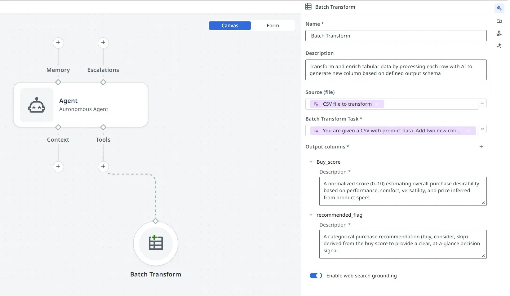

Configure inputs
At design time, you specify how the tool should receive its input:
Source file: The source is a file input (for example,
input-csv). At runtime, this resolves automatically to the file provided when the agent runs.Note:You must configure a file type argument in Data manager.
Batch Transform task - The tool-specific instruction that defines how the batch transform should be performed. Use this field to tell the tool exactly how to process the input file, including:
- What new columns or rows to generate
- How each row should be processed
- Any rules, criteria, or decision logic to apply
For example, you might instruct the tool to generate two new columns such as a score and a recommendation flag based on the contents of each row. This is not an agent prompt. The agent should only include a high-level instruction for when to invoke the batch transform and what the final output should look like.
Output columns — Define the schema for any new columns generated by the batch transform. For each column, specify:
- The column name
- A description of what the column represents and how its values should be interpreted
You can add new output columns, edit existing column names or descriptions, or remove columns as needed. The Batch Transform task should describe the logic used to populate these configured columns.
Enable web search grounding (optional)
The Batch Transform tool includes an optional web search grounding setting that controls whether the model is allowed to use web search results when generating transformations.
- When enabled, the model can supplement the input file data with information retrieved from the web while processing each row.
- When disabled, the transformation is performed strictly using the contents of the input file, the instructions defined in the task, and any context explicitly provided to the agent.

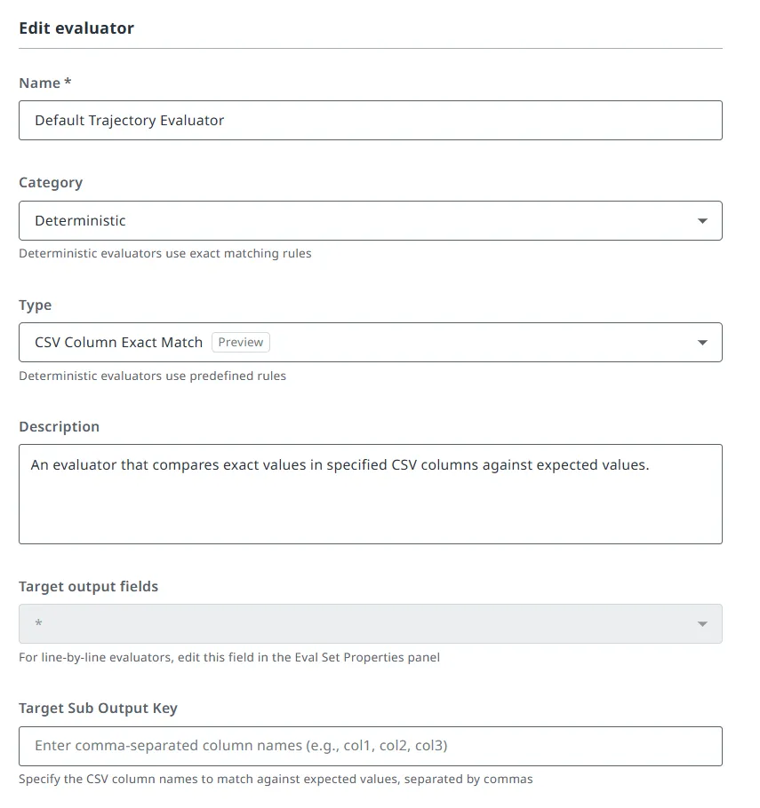

CSV Column Exact Match evaluator
To support structured file evaluation, a deterministic evaluator called CSV Column Exact Match Evaluator is available. For details, refer to Agent evaluations.
This evaluator:
- Compares one or more specified columns between expected and actual outputs
- Performs an exact string match
- Returns pass/fail results per row
CSV Column Exact Match Evaluator is well suited for validating categorical outputs such as labels, match types, or status fields.
