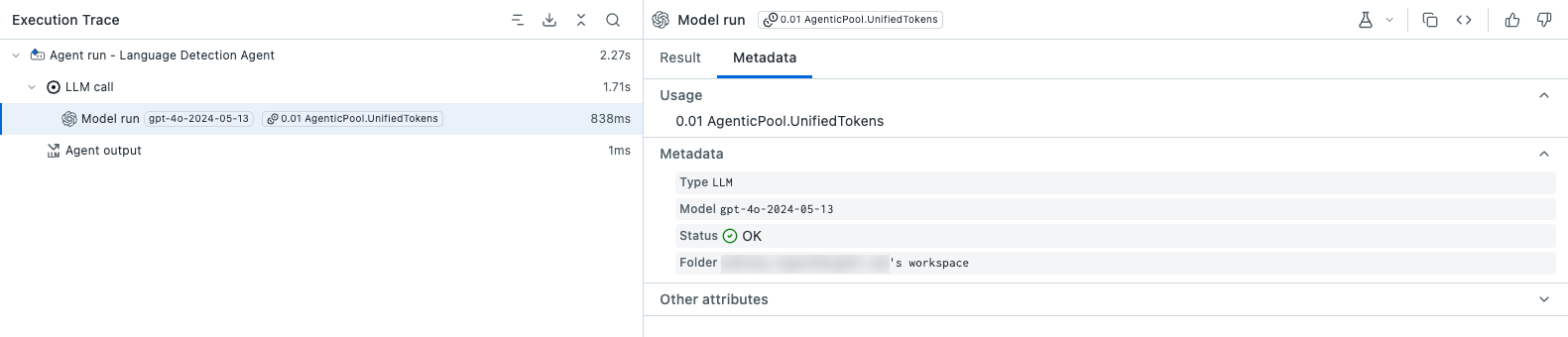

Traces show how much a run draws from your licensing entitlement, span by span. Spans that consume display a usage badge next to the span name, showing the amount and the unit it is drawn from.
Consumption is reported on the span that performs the billable operation. For an agent run, this is the Model run span inside each LLM call. A span without a badge is not necessarily free. Its cost is either reported on one of its child spans, or included in the total on the nearest parent that shows a badge.
Selecting a span and opening the Metadata tab shows the amount and unit in the Usage section.
