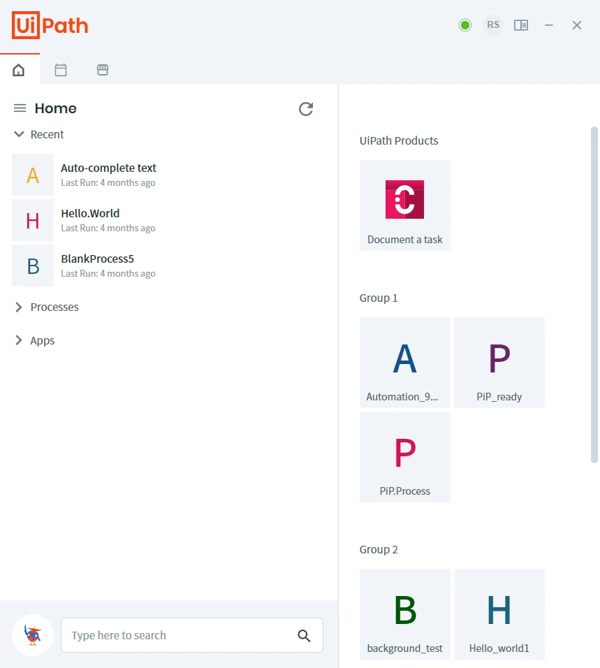

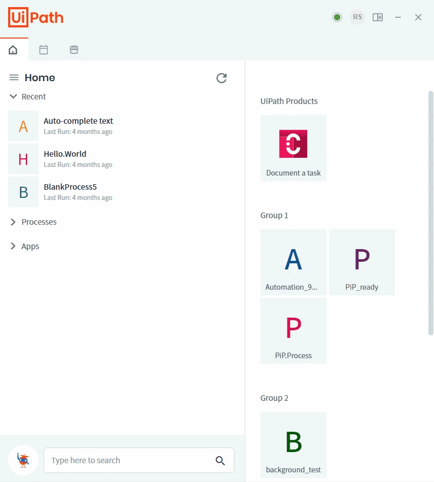

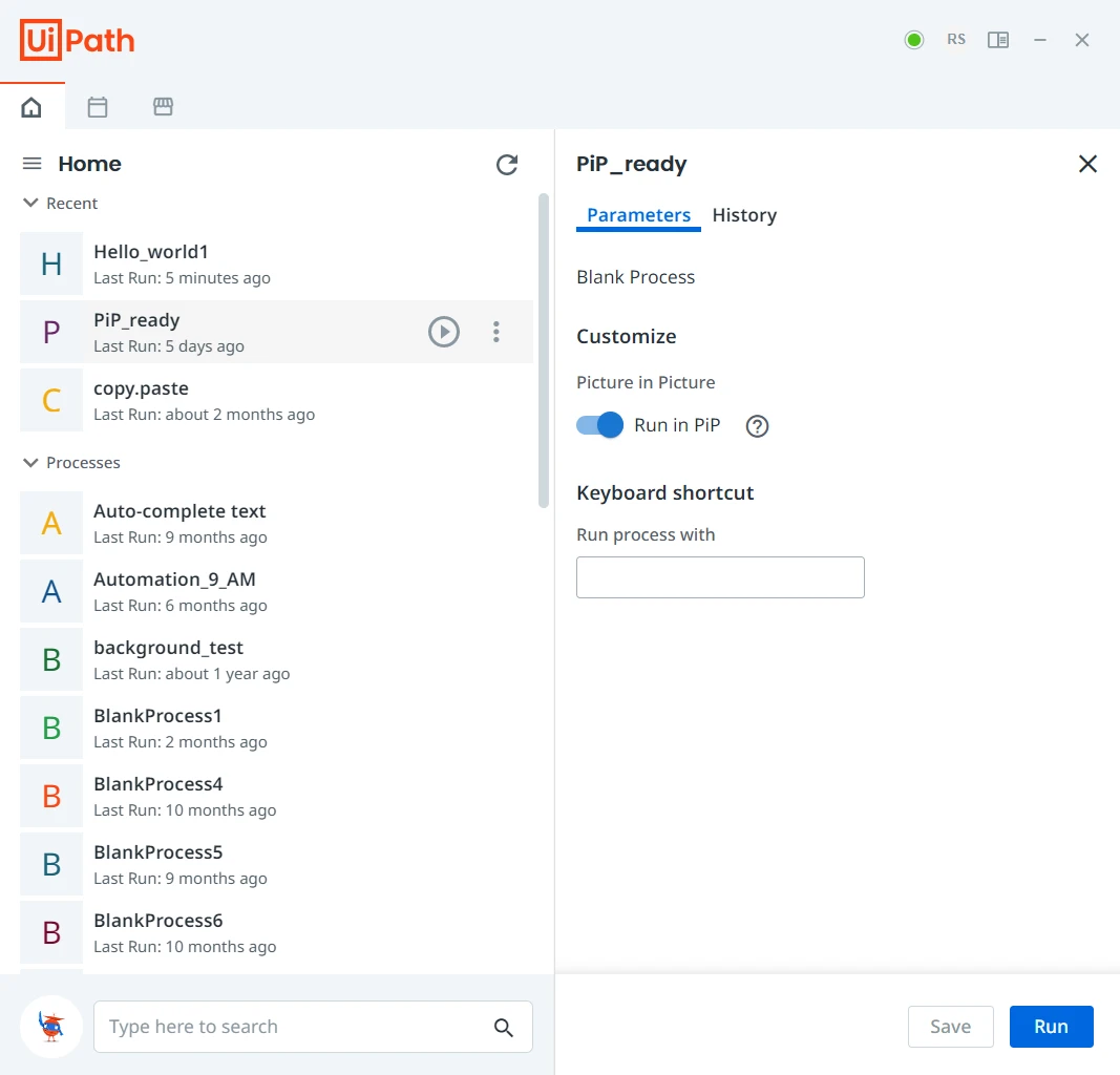

UiPath Assistant 的界面采用两列设计:
The left side contains the tabs (Home, Reminders, and Marketplace), while the right side, also named "The Launchpad" has your favorite processes to provide easier access to them. You can drag and drop them to arrange them and create sections as shown below. The right side also displays the Process Details when used.
在 UiPath Assistant 的底部,您可以找到“机器人身份”和搜索栏,可用来更轻松地查找流程。
When you have the Automation Store Widget deployed, the search functionality also returns related ideas that are part of Automation Hub, but not deployed in the Automation Store.

主页选项卡
“主页”选项卡用于:
  • 查看所有可用的自动化流程:
    • If UiPath Assistant is connected to Orchestrator, processes from the environments and folders the Robot is a part of are displayed. Hovering over a process displays its name, version and folder.
    • If UiPath Assistant is set tooffline mode, automations in the %ProgramData%\UiPath\Packages folder are displayed.
  • 下载拥有最新版本,或需要在本地下载和解压的流程,并查看其安装状态。
  • 在启动台中添加或删除流程,单击上下文菜单,然后选择“固定到启动台”,或简单地将流程从左面板拖放到启动台。
  • 查看目前正在运行的所有前台和后台流程。
  • 暂停、继续或停止流程。可通过“Studio 流程设置”窗口禁用流程的“暂停”按钮。启动流程后,系统将显示执行状态。您可以使用“报告状态”活动在执行期间显示自定义状态消息。

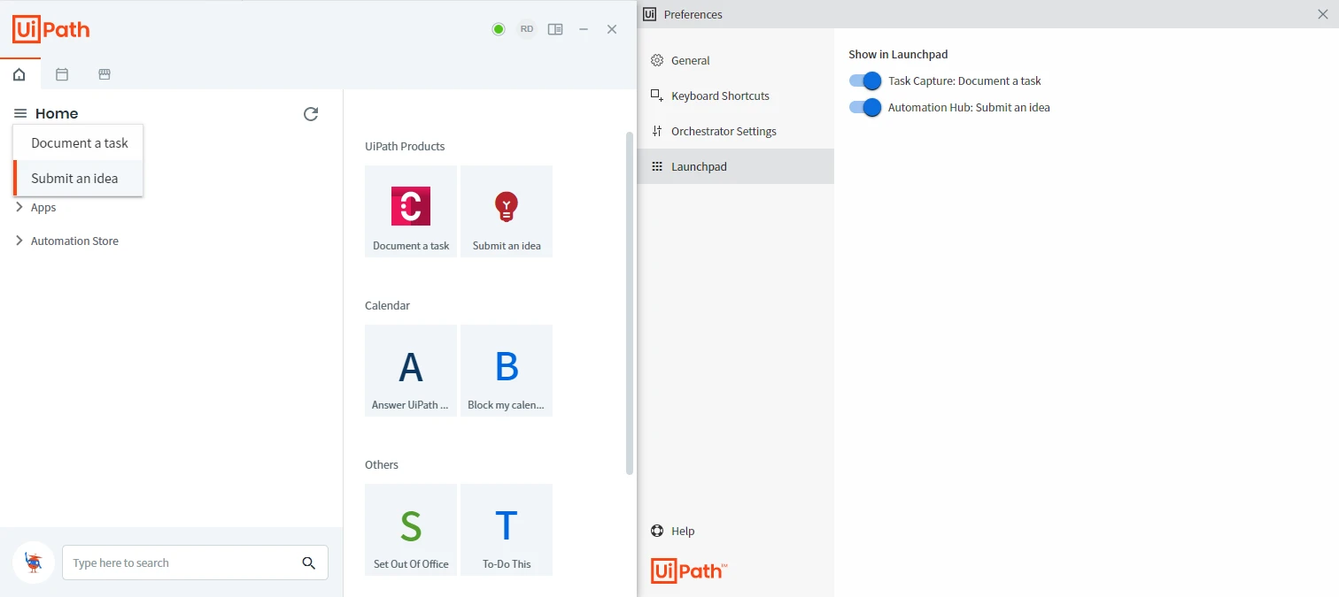

UiPath 产品组
In the launchpad, you can find the UiPath Products Group, which contains the Task Capture Launcher and the option to submit an idea to Automation Hub. They can also be accessed from the menu right next to Home.
您可通过 UiPath Assistant“首选项”菜单中的“启动台”禁用此部分。
备注:
要禁用 Task Capture,请打开 agent-settings.json,然后在 user 条目下方(和外部)添加 disableTaskCapture: true。

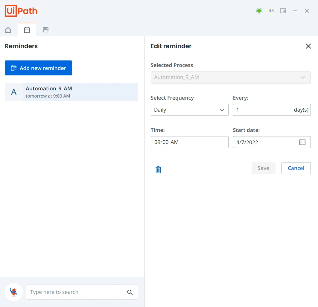

提醒选项卡
“提醒”选项卡用于指定接收流程启动通知的时间或周期。对于“流程列表”版块中的任何可用流程,您可以设置提醒。
设置了提醒的流程将显示在“提醒”选项卡上,并且在流程即将开始时,系统便会显示提醒。请注意,未经您的同意,流程不会开始。您可以将提醒推迟 10 分钟,将其关闭或开始流程。

流程详细信息
“流程详细信息”子菜单提供以下内容:
  • 流程名称和说明 - 这些基于创建流程时在 Studio 中提供的详细信息
  • Input Arguments used to configure processes that make use of input arguments. If an Input Argument is mandatory, it is marked by an asterisk * next to its name.

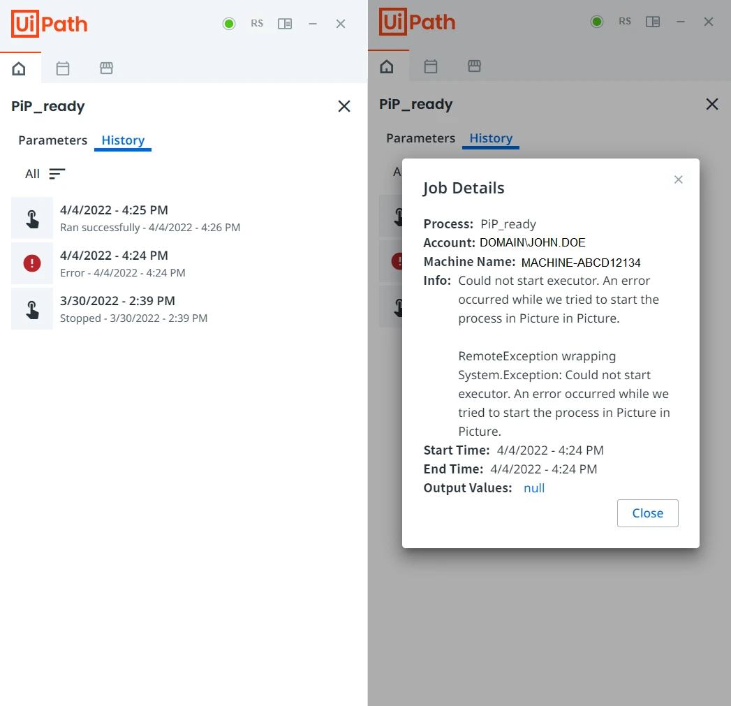

    历史记录 - 显示流程的执行历史记录,单击事件将显示其他详细信息。
  • The Start in PiP toggle is inherited from the project settings in Studio. If a process is set to Start in PiP in Studio, the toggle is enabled. Changing it from the UiPath Assistant overwrites the setting from Studio.
  • 键盘快捷键 - 提供了用于设置启动流程的键盘快捷键的选项。

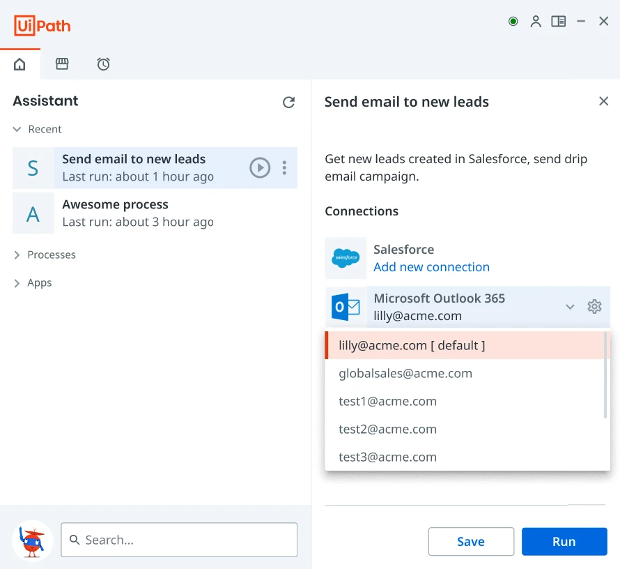

UiPath Assistant 中的连接​
通过访问“流程详细信息”菜单,您可以直接在 UiPath Assistant 中使用 连接 。
如果某个流程已建立连接,则用户可以从列表中选择。否则,他们可以从同一菜单创建一个新连接。
如果一个连接绑定了多个帐户,可以从下拉列表中选择一个特定帐户。

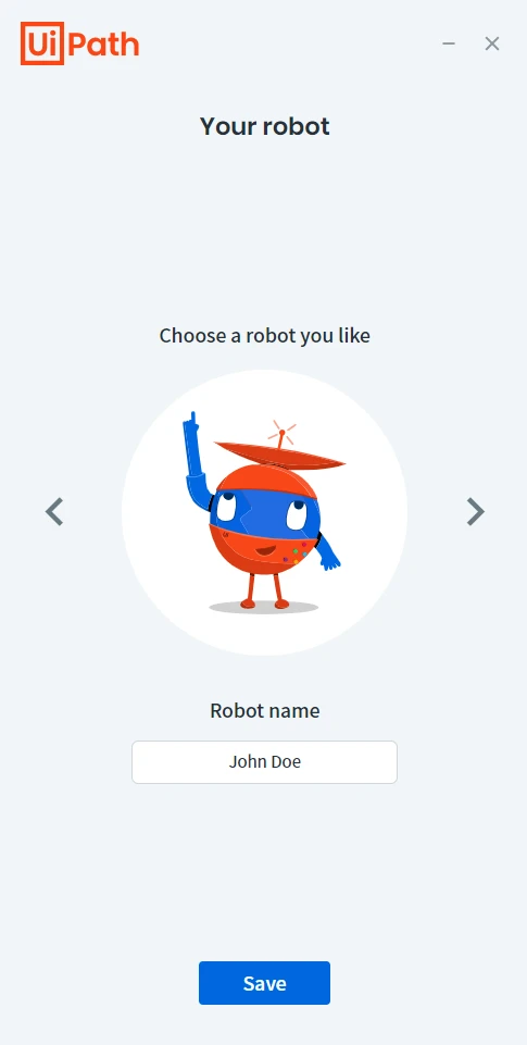

您的机器人​
为了使机器人更加人性化,您可以通过选择图片和名称来赋予其身份。首次打开 UiPath Assistant 时会完成此操作,但是可以随时单击搜索栏旁边的机器人并在其上悬停以显示名称来进行更改。
