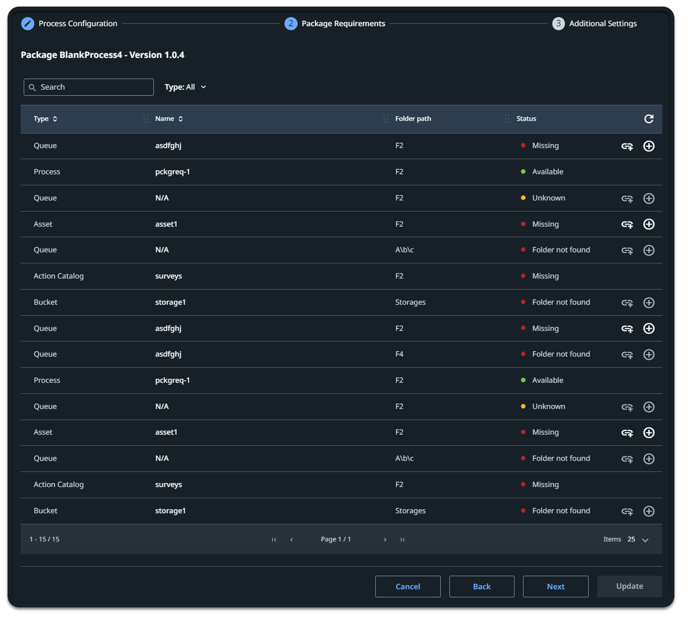

Figure 1. Package Requirements page

Package Requirements Statuses
General statuses
- Available - the object is present in Orchestrator. No further action needed.
- Missing - the object is not present in the current folder in Orchestrator. You can either link it or add it into the corresponding Orchestrator folder, provided you have the proper permissions.
- Folder not found - the object supposedly exists in an Orchestrator folder that was referenced in the Folder path field of an activity, but:
- the folder does not exist in Orchestrator. You should add the folder in Orchestrator, use the same name as indicated in the Folder path column, and assign users to it.
- you do not have access to that folder. You should ask for access to the Orchestrator folder indicated in the Folder Path column.
- Unknown - the object name could not be determined. No available actions to perform. There are several scenarios which may result in an Unknown status:
- you do not have the correct permissions set for that type of object;
- a workflow activity references a queue item, for example, which cannot be linked to its queue. Note: The unknown status of an object does not prevent the process from executing successfully.

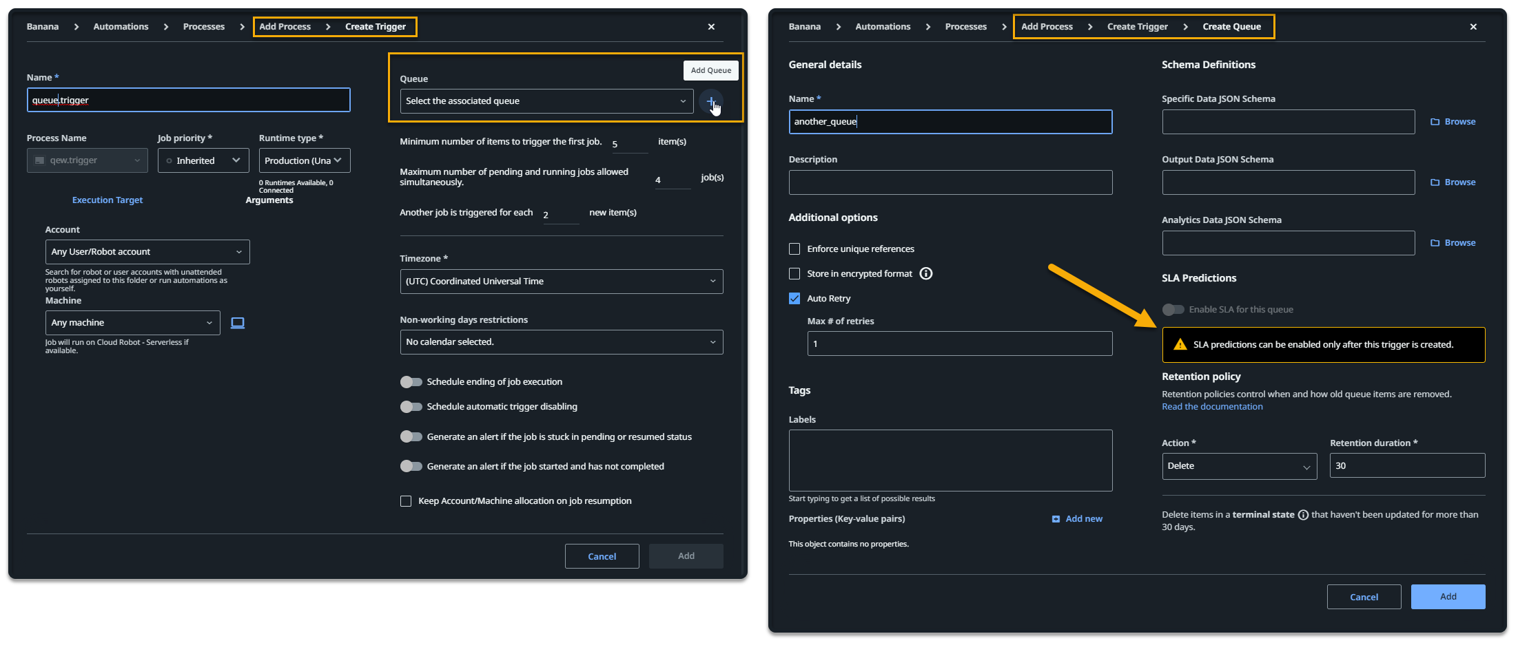

Adding time and queue triggers
Adding a time or a queue trigger prepopulates the fields on the Create Trigger page with the values set by the RPA developer in the associated trigger activity, during design-time. You can edit these values while the trigger has the Pending creation status or later from the Edit trigger page. The Pending creation status means the trigger is stored in a temporary memory until the process it needs is created.
Go to Automations > Processes and Select Add process.
Select the package that contains the time trigger activity.
Input the required runtime arguments, then Select Next.
The package requirements page displays the time trigger with the Missing status. Select the Add trigger button to configure the time trigger.
Configure the trigger properties as instructed on the Creating time triggers/Creating queue triggers page. The time/queue trigger status changes to Pending creation.
Select Next to continue configuring the process, and then select Create.
Once the process is created, the time/queue trigger appears in the Time/Queue Triggers grid in Orchestrator.
You have the option to add a queue during the creation of a missing queue trigger. Be aware that doing so restricts you from adding SLAs to the queue until the trigger is created.
Figure 2. Adding queues from the queue trigger creation page
