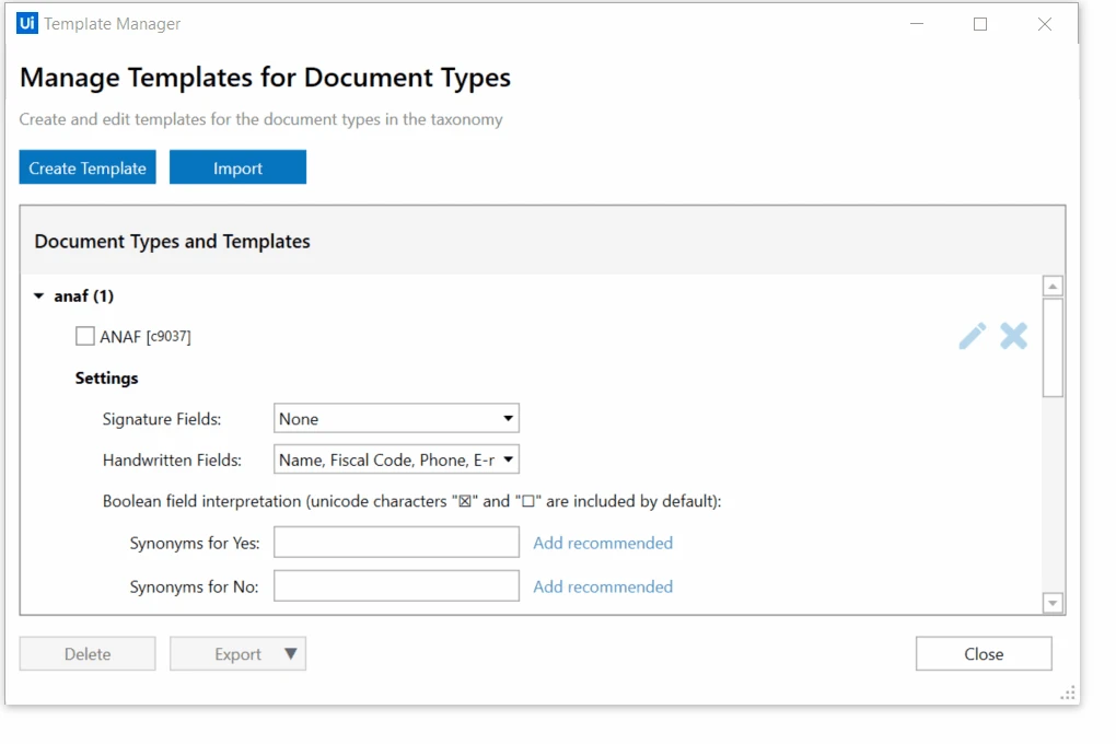

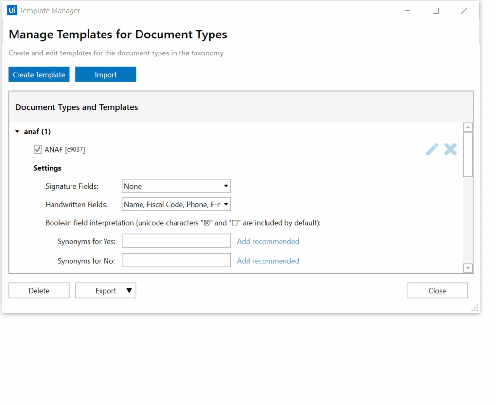

Building on top of the Form Extractor, the Intelligent Form Extractor has the same configuration options, with extra settings available for processing Handwritten Fields (fields that may appear either printed or handwritten within a document), and Signature Fields (fields that need to capture whether there is a signature present in a given area of the document, or not).
A continuación, se detallan las opciones de configuración del Gestor de plantillas.
Asistente del Administrador de plantillas​
La creación, edición, eliminación, importación y exportación de plantillas se realizan del mismo modo que en el caso del Extractor de formularios.
Please review the associated documentation for these functionalities.
The Signature Fields and Handwritten Fields allow you to specify which fields from a given document type should be processed for Handwriting and which fields should be processed for Signature Detection. Multiple checkboxes can be selected from the drop-down list of each option.
