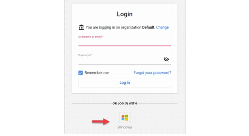

Now that the UiPath platform is integrated with Windows Authentication, users for which a user account is created in UiPath can use the Windows option on the Login page to sign in to the UiPath platform.
Each organization administrator must do this for their organization if they want to allow login with Windows credentials.
  1. Log in as an organization administrator.
  2. Assign an organization-level role to an Active Directory user or group, which you can select from search.
  3. Repeat the previous step for each user you want to allow to log in with Windows Authentication.
The users to which you assigned roles can then log in to the UiPath organization with their Active Directory account. They must log in from a domain-joined machine.
