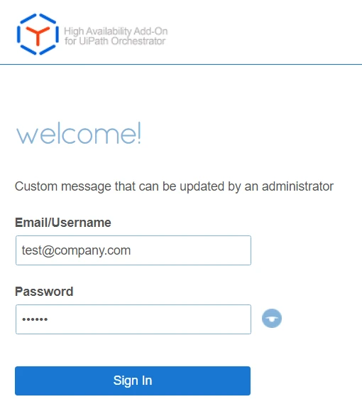

  1. Navigate your browser to the IP address of any HAA node on port 8443. For example: https://10.10.20.196:8443/. The HAA login page is displayed.
  2. Enter the username and password provided during the installation to login.

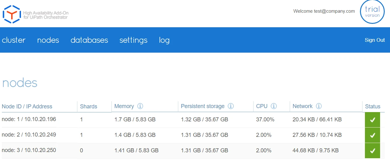

  3. Select the nodes tab and verify that all installed nodes appear here with a status of OK.
  4. Select the databases tab and confirm that the uipath-orchestrator database appears here with a status of OK.
  5. If deployed on more than one node, ensure that Replication is enabled in the database settings and that two nodes are showing a shard count of 1. This ensures that the database is replicated on two nodes.
