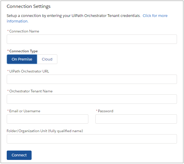

The Connection Settings feature is where you enter the following information to establish a connection between Salesforce and an Orchestrator or UiPath Automation Cloud tenant:
For an Orchestrator tenant, the connection settings are:
  • Orchestrator URL
  • Tenant Name
  • Named Credential / User Credentials (Username and Password)
  • Folder (Classic Folder or Modern Folder)

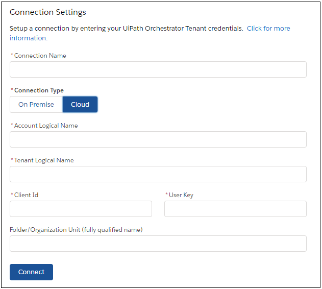

For an Automation Cloud tenant, the connection settings are:
  • Account Logical Name
  • Tenant Logical Name
  • Named Credential / API Access Key (Client Id and User Key)
  • Folder (Classic Folder or Modern Folder).

On-premise (UiPath Orchestrator)​
This section describes the connection settings data fields if you are using the UiPath Orchestrator.
ParameterDescription
Connection NameA unique name for your connection. This name is only used in the UiPath Add-in for Salesforce application and it does not need to match the name of the Tenant that you're connecting to. Your name can include alphanumeric characters (a-z, 0-9), special characters, and spaces.
EnvironmentOn Premise
Connection TypeNamed Credential. For more information, access our Named Credentials guide.
Named CredentialSelect the desired Named Credential.
Orchestrator Tenant NameThe name of the Tenant that you're connecting to Salesforce. This name must match the name of your Tenant in UiPath Orchestrator.
Folder/Organization UnitThe fully qualified name of the folder. If you leave this field empty, it chooses "default" as folder name (you must make sure you have a default folder in your Orchestrator).
Save (button)Saves and verifies the authentication details by establishing a connection between Salesforce and UiPath Orchestrator. If the connection is unsuccessful, a red notification stating "Unable to authenticate UiPath credentials. Please verify and try again." appears at the top of the screen. To resolve the issue, verify your form entries and click the Connect button again.
Cloud (UiPath Automation Cloud)​
This section describes the connection settings data fields if you are using the UiPath Automation Cloud.
These settings can be obtained as follows:
  1. Log in to your UiPath Automation Cloud account.
  2. Navigate to Services.
  3. For the service you are going to connect to, select Named Credentials.
  4. Note the values of Account Logical Name, Tenant Logical Name, Client Id, and User Key.
EnvironmentCloud
Account Logical NameThe logical name of your Automation Cloud account.
Tenant Logical NameThe logical name of your service.
FolderThe fully qualified name of the folder. If you leave this field empty, it chooses "default" as folder name (you must make sure you have a default folder in your Orchestrator).
