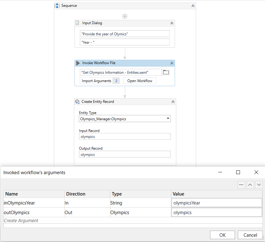

Create data records
Once the data was collected, you can use the Create Entity Record activity to add the information to Data Fabric.
In this example, we used the imported arguments to pass the collected information to Data Fabric. The Input and Output records are the values of variables of type Olympics used for passing along the data.

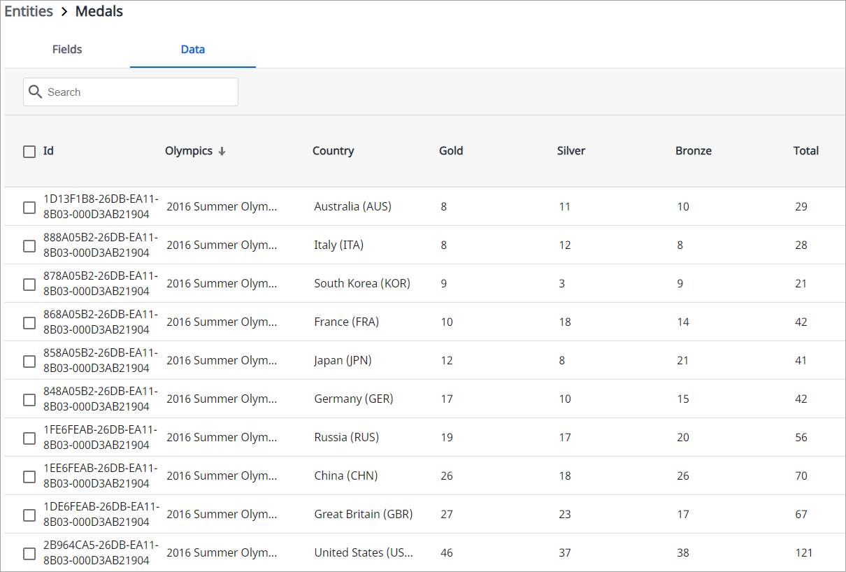

Create records with structured data
Records structured in a data table can be passed along to Data Fabric using the For Each Row activity. In this example, we're invoking a workflow that collects structured data on the number of medals won by each country and passes these records along to Data Fabric.
After running the workflow, the following data is stored in Data Fabric:
The relationship set between the Olympics and Medals entities allows us to use the data record from one in the other. For example, the value of the Olympics field inside the Medal entity is the same as in the related entity.

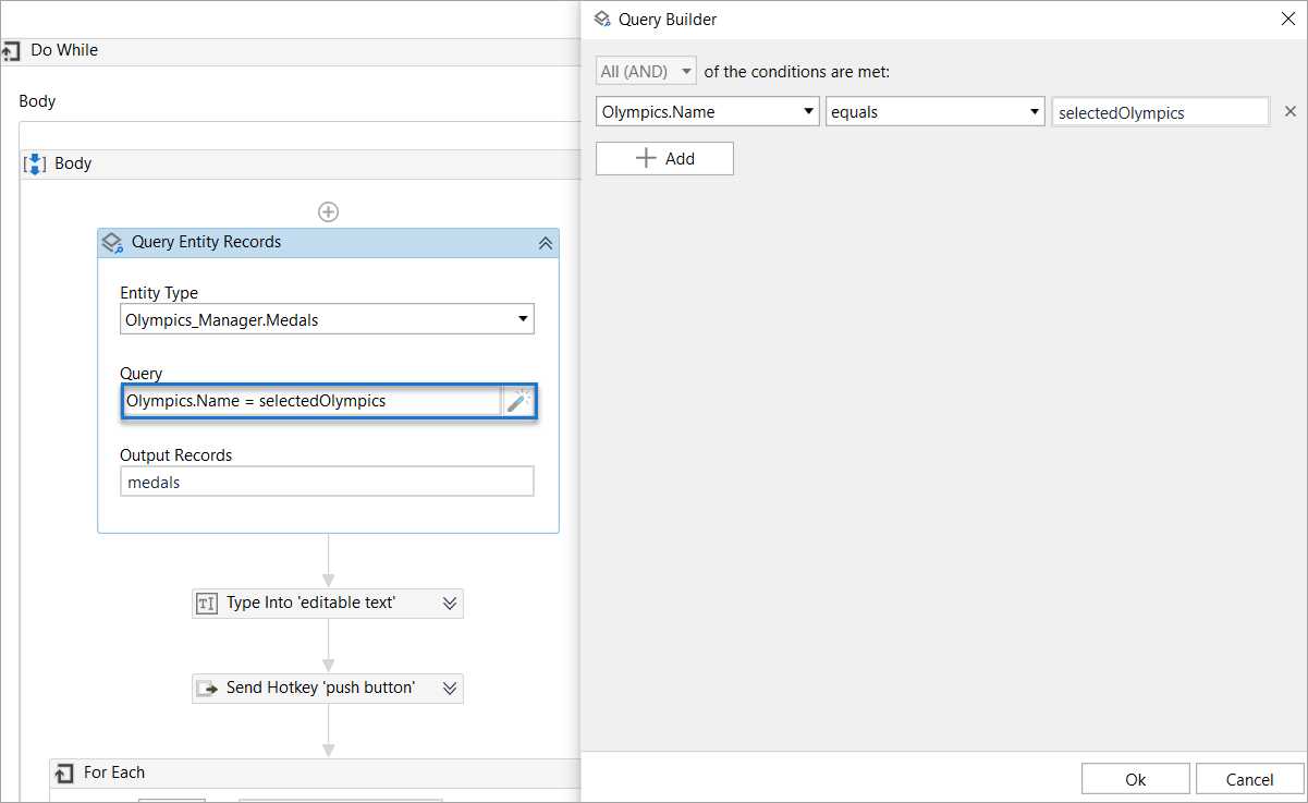

Query related records
The Query Entity Records activity can be used to pull up a list of records from Data Fabric. In the following example, we use the activity to query data records from the Olympics entity, allow the user to choose an Olympics edition, and from the Medals entity write the number of medals that each participating country won.
For querying the Olympics table, we've used the Name != NULL condition from the Query Builder. This goes through all records from the Name column and outputs them in the listOlympics variable to be used in the Input Dialog activity.
To show the list of records as options, we've used the following Lambda expression listOlympics.Select(Function (o as Olympics) o.Name).ToArray in the Input Dialog activity. Alternatively, the For Each activity can be used.
The selection is mapped to the selectedOlympics variable and used in another Query Entity Records activity for going through the list of medals won at that specific edition. This condition was set by using the equals option in the Query Builder.
The query can be performed on the selected entity, and on related entity records as well.
