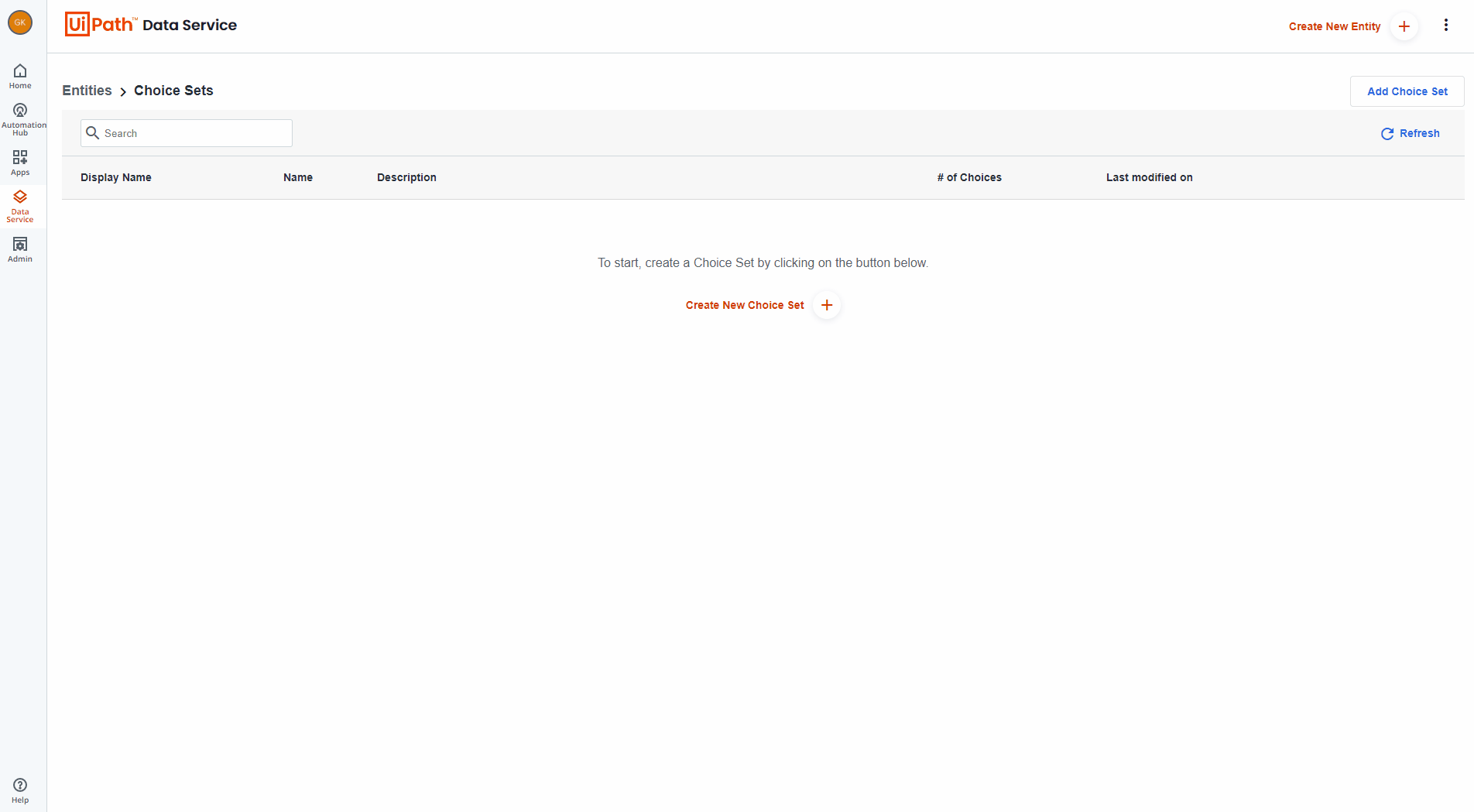

Accessing the choice sets module
In the Data Fabric / Data Service service, select Manage Choice Sets. The Choice Sets page is displayed.
Creating a choice set
  1. On the Choice Sets page, select Add Choice Set. The Create Choice Set panel is displayed.
  2. In the Display Name field enter a display name for the choice set.
    Note:
    The Name field is automatically filled in based on the Display Name. If needed, you can update it.
    You can create a maximum of 250 choices in a choice set.
  3. Select Add Choice.
  4. Enter a name in the new choice display name field.
  5. In the Location section:
    1. Select Tenant to make data available across the entire tenant to all users with tenant-level access.
    2. Select Folder to make data visible only to users with access to the selected Orchestrator folder. If you select Folder, you then have to select a target Orchestrator folder from the Select Folder dropdown. The choice set you create is scoped for the folder you select.
      Note:
      You cannot change the choice set location once chosen.
  6. Repeat steps 3 and 4 for the other choices you want to add to the choice set.
  7. Select More details to display an additional Description field. If needed, enter a description to indicate the function of the choice set.
  8. Select Save.
The new choice set is displayed in the Choice Sets list.
