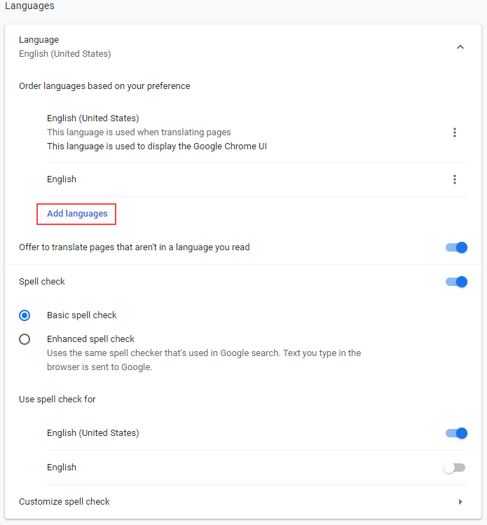

Location-specific Format
To view the date in the format specific to your locale in Google Chrome, follow the steps below:
Go to the following address in Google Chrome:
chrome://settings/languages. -
Add the missing language.
Move the language to the top of listed languages.
Restart Google Chrome.
Re-open your app and preview it.
Select the date in the Date Picker control. The date should now be displayed in the format specific to your locale.
