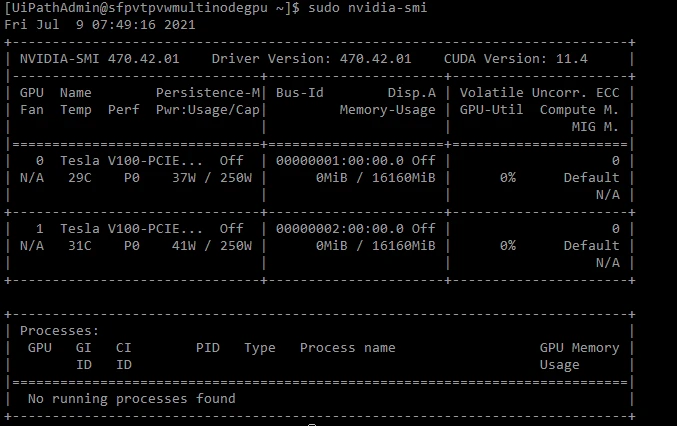

Verify if drivers are installed properly
Run sudo nvidia-smi command on the node to verify if the drivers were installed properly.
