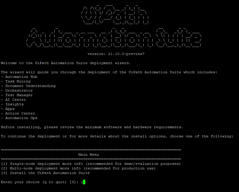

Run the interactive install wizard to configure the installation options:
- Interactive wizard will guide through the configuration steps and generate the config file which can be then customized and used through the remaining install steps.
Run the script the begin the interactive wizard by running the following command:
chmod +x ./installUiPathAS.sh ./installUiPathAS.shchmod +x ./installUiPathAS.sh ./installUiPathAS.sh -
Follow the steps in the wizard
Make sure to not start the install from the script and exit it when config file is generated, it will try to install full Automation suite otherwise. This script is primarily used for Automation Suite and the displayed information (products, requirements) is relative to Automation Suite. The config file will be adapted to our needs in the next steps of the procedure.
Follow the deployment configuration steps:
Accept the license agreement.
Select the deployment mode: select the Single-node deployment option.
Select continue.

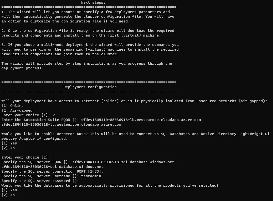

Select Air-gapped installation.
Enter the DNS hostname.
Specify whether you want to use Kerberos Auth for SQL connections.
Enter the SQL Server URL. Follow the prompt to enter the connection port, username, and password.
Specify whether you want the installer to automatically create the necessary databases.
The cluster configuration file will be generated with a folder as shown in the following image.
As soon as you generate the configuration file and the folder, you can exit the wizard and proceed with the remaining steps below to complete installation. You can ignore the list of products as we will update this in the following steps.
