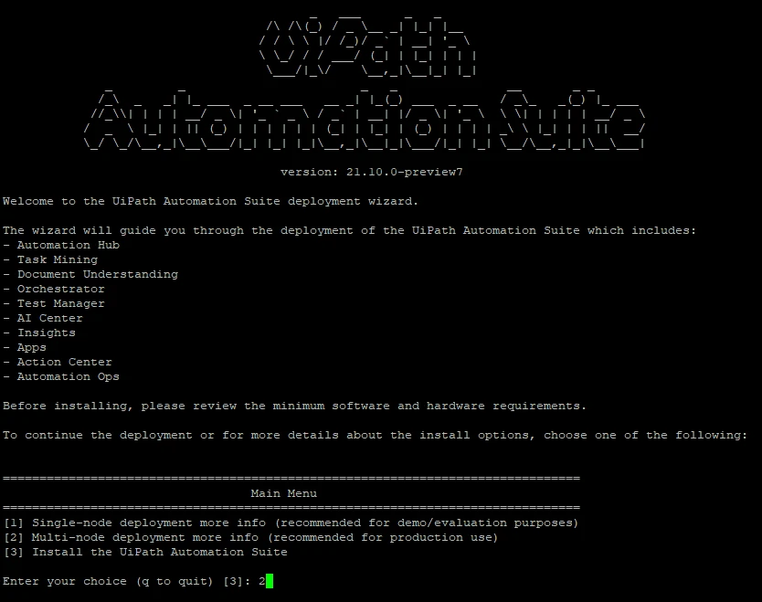

Screen-by-screen sequence
Upon starting the installation wizard, the main menu is displayed. From this menu you need to choose the desired deployment mode: single-node or multi-node. You are prompted with details about each mode once a choice is made. After that, you have the option to continue with the current choice or go back to the main menu.
Accept the license agreement.
Select the deployment mode: select the Multi-node deployment option.
Select continue.

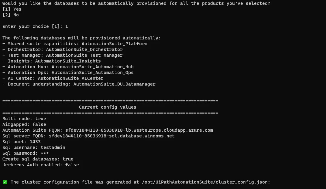

Specify whether you want the installer to automatically create the necessary databases.
The cluster configuration file will be generated with a folder as shown in the following image.
As soon as you generate the configuration file and the folder, you can exit the wizard and proceed with the remaining steps below to complete installation. You can ignore the list of products as we will update this in the following steps.
A first version of the cluster_config.json file is now generated. We will update this file to the purpose of the AI Center installation.

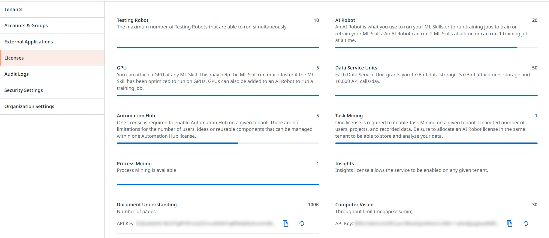

metering_api_key is the Document Understanding API Key from the AI Center cloud account as in the screenshot below.
