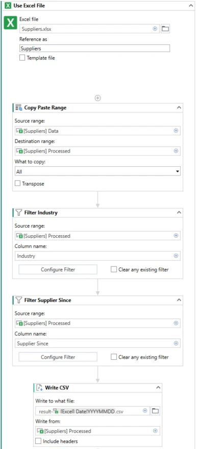

  2. 步骤 2:将 Excel 文件添加到项目中。
    1. Click Add activity 文档图像 in the Designer panel, and then find the Use Excel File activity in the search box at the top of the screen and select it. A Use Excel File activity is added to the Designer panel.
    2. 在活动中:
      • Click Browse文档图像 next to the Excel file field, and then browse to and select the file Suppliers.xlsx
      • 在“引用为”字段中,输入 Suppliers。
        您已指明将使用自动化中称为 Suppliers 的文件 Suppliers.xlsx。
  3. 第 3 步:筛选数据并将其复制到 CSV 文件。
    1. Click Add activity 文档图像 inside the Use Excel File and then, in the search box at the top of the screen, locate and select Copy Range. A Copy Range activity is added to the Designer panel.
    2. 在“复制范围”活动中:
      • Click Plus文档图像 on the right side of the Source range field, and then select Suppliers > Data [Sheet].
      • Click Plus 文档图像 on the right side of the Destination range field, and then select Suppliers > Processed [Sheet].
        您已指明要复制“Suppliers”文件的“Data”工作表中的数据,并将其粘贴到同一文件中的“Processed”工作表中。
    3. 在 StudioX 功能区中单击“保存”,以保存自动化,然后单击“运行”来执行此自动化。
      数据从“Data”工作表复制到“Suppliers”工作簿中的“Processed”工作表。
    4. Click Add activity 文档图像 inside the Use Excel File just below the Copy Range activity, and then, in the search box at the top of the screen, locate and select Filter. A Filter activity is added to the Designer panel.
    5. 在“筛选”活动中:
      • Click Plus文档图像 on the right side of the Source range field, and then select Suppliers > Processed [Sheet].
      • Click Plus文档图像 on the right side of the Column name field, and then select Range > Industry.
      • 单击“配置筛选器”按钮。在“筛选器”窗口中,确保选中“基本筛选器”,然后:
        • Click Plus文档图像 on the right side of the Value field, and then select Text. In the Text Builder, enter Services, and then click Save.
        • ClickAdd to add a second value.
        • 单击字段右侧的“加号”文档图像 ,然后选择 文本。在文本生成器中,输入IT ,然后单击“保存”,接着单击“确定” ,关闭筛选窗口。
          您已指明要筛选“Processed”工作表中的数据,以便在“Industry ”列中仅显示值为“Services ”或“IT”的行。
    6. Click Add activity 文档图像 inside the Use Excel File just below the Filter activity, and then, in the search box at the top of the screen, locate and select Filter. A second Filter activity is added to the Designer panel.
    7. 在第二个筛选活动中:
      • Click Plus文档图像 on the right side of the Column name field, and then select Range > Supplier Since.
      • 单击“筛选”按钮。在“筛选”窗口中:
        • Select Advanced filter.
        • 从“运算符”下拉菜单中,选择“>”(大于)。
        • 单击字段右侧的“加号”文档图像 ,然后选择 文本。在文本生成器中,输入 10 年前的一个日期,例如5/5/2009 ,然后单击“保存”,接着单击“确定” ,关闭筛选窗口。
          您已指明要筛选“Processed”工作表中的数据,以便在“Supplier Since”列中仅显示日期为“5/5/2009”之后的行。
    8. 要使“筛选”活动更容易识别,请在每个活动的上部栏中编辑名称。例如第一个活动使用 Filter Industry,第二个活动使用 Filter Supplier Since。
    9. Click Add activity 文档图像 just below the Use Excel File activity, and then, in the search box at the top of the screen, locate and select Write CSV. A Write CSV activity is added to the Designer panel. Alternatively, you can also add this activity inside the Use Excel File activity, just below the last Filter activity.
    10. 在“写入 CSV”活动中执行以下操作:
      • Click Plus文档图像 on the right side of the Write to what file field, and then select Text. In the Text Builder, enter result-, and then from the Plus文档图像 menu on the right side of the Text Builder select Project Notebook (Notes) > Date [Sheet] > YYYYMMDD [Cell]. The text in the Text Builder is updated to result-Excel Date!YYYYMMDD. Enter the text .csv at the end and click Save. The final text should be result-Excel Date!YYYYMMDD.csv.
      • 单击字段右侧的“加号”文档图像 ,然后选择“供应商” >“已处理的[工作表]” 。
        您已经表明要在项目文件夹中创建一个 CSV 文件,其名称包含文本“result-”和今天的日期,并且您要将“Processed”工作表中的数据复制到其中。

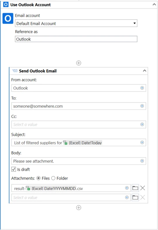

    1. Click Add activity 文档图像 below the Use Excel File activity, and then find the Use Desktop Outlook App activity in the search box at the top of the screen and select it. A Use Desktop Outlook App activity is added to the Designer panel.
    2. 在活动中,“帐户”字段中已经选择默认的电子邮件帐户。如果您要使用其他帐户,请从下拉菜单中选择。
      在“引用为”字段中,保留默认值 Outlook 作为在自动化中引用该帐户时使用的名称。
    3. Click Add activity 文档图像 inside theUse Desktop Outlook App activity, and then, in the search box at the top of the screen, locate and select Send Email. A Send Email activity is added to the Designer panel.
    4. 在"发送电子邮件"活动中:
      • Click Plus文档图像 on the right side of the From account field, and then select Outlook.
      • Click Plus文档图像 on the right side of the To field, and then select Text. In the Text Builder window, enter an email address where to send the email. For example, you can enter your own email address to send the email to yourself. If you leave the Is draft option selected, the automation does not send the email, it instead saves the email to the Outlook Drafts folder.
      • Click Plus文档图像 on the right side of the Subject field, and then select Text. In the Text Builder window, enter List of filtered suppliers for, and then, from the Plus文档图像 menu on the right side of the Text Builder, select Project Notebook (Notes) > Date [Sheet] > Today [Cell]. The final text should look like this: List of filtered suppliers for [Excel]Date!Today. Click Save to close the Text Builder.
      • Click Plus文档图像 on the right side of the Body field, and then select Text. In the Text Builder window, enter text for the body of the email, for example Please see attachment.
      • 对于附件,选择文件,然后单击加号文档图像然后选择文本。在文本生成器中,以与在“写入 CSV”活动中输入文件相同的方式输入文件名: result-Excel Date!YYYYMMDD.csv 。执行此操作的一个方法是在“写入 CSV”活动中选中“写入到什么文件”字段的文本生成器中的所有文本,复制文本,然后将其粘贴到“附件”字段的文本生成器中。
