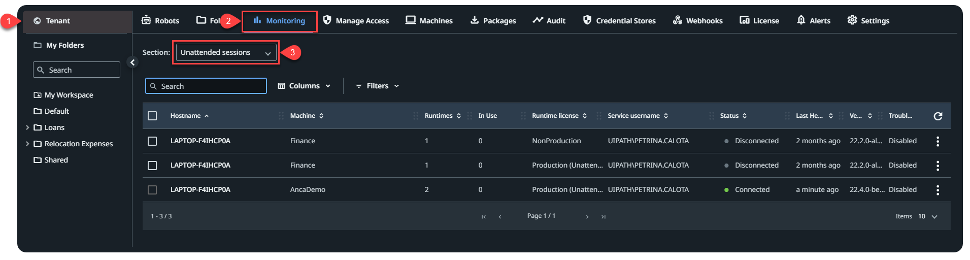

Removing Unattended Sessions Individually
To remove the unattended sessions one by one, follow these steps:
  1. Navigate to Tenant > Monitoring > Unattended sessions.
  2. For the disconnected or unresponsive session you wish to remove, click More actions > Remove.
  3. Click Delete to confirm the deletion when prompted. The unattended session is removed from the Unattended sessions view and the Installed Versions & Logs window.
