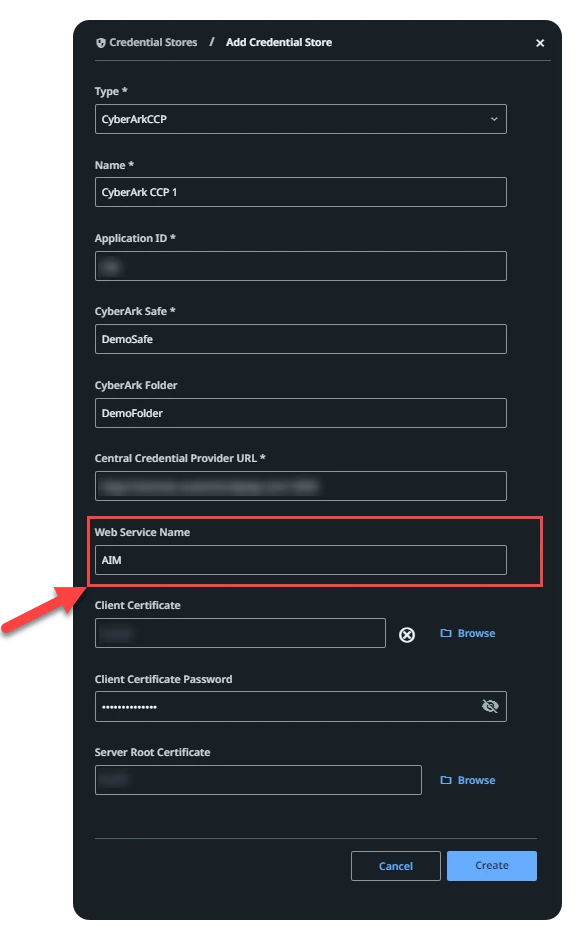

Custom AIMWebserviceName​
From now on, you can give a custom name to the Central Credential Provider web service. To this end, a new field is available when configuring a CyberArk CCP credential store that allows you to set the service name, Web Service Name. Leaving this field empty means the default name is used: AIMWebService.
