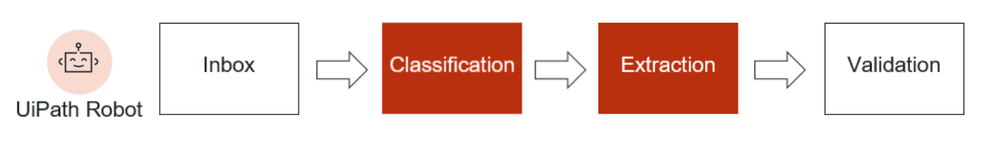

Using Document Understanding classification with IXP extraction
Document Understanding and IXP licenses can be used together. You can classify a document with a Document Understanding modern project classifier and then extract data with an IXP model, with no additional Platform Unit cost per page.
The page is charged for classification (0.04 Platform Units) and extraction with prior classification (0.16 Platform Units), with a total of 0.2 Platform Units per page.

Classification and an IXP unstructured project
The following table provides an example of the consumed units when using classification and an IXP unstructured project:
| Input | Classification | Extraction | Extraction | Platform Units consumed |
| 50-page document | Modern | IXP Unstructured and complex documents | N\A | 10 |
| 50-page document | Gen Class | IXP Unstructured and complex documents | N\A | 10 |

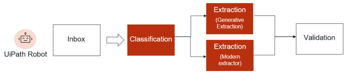

Multiple extractors
The following table provides an example of the consumed units when using multiple extractors:
| 50-page document | N\A | IXP Unstructured and complex documents | Modern | 20 |
| 50-page document | N\A | IXP Unstructured and complex documents | Classic project | 20 |
| 50-page document | N\A | IXP Unstructured and complex documents | IXP Unstructured and complex documents | 20 |
Using a classic classifier, such as the Intelligent Keyword Classifier (IKC), does not qualify subsequent extractions for the reduced 0.16 rate.
Classification and multiple extractors
The following table provides an example of the consumed units when using classification and multiple extractors:
| 50-page document | Modern | IXP Unstructured and complex documents | Modern | 18 |
| 50-page document | Gen Class | IXP Unstructured and complex documents | Classic project | 20 |
| 50-page document | IKC | IXP Unstructured and complex documents (30 pages) | Modern project (20 pages) | 10.2 |
